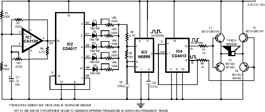

Try this one.
Hope it will help you!!!!!

Here is one with 555 chip:
