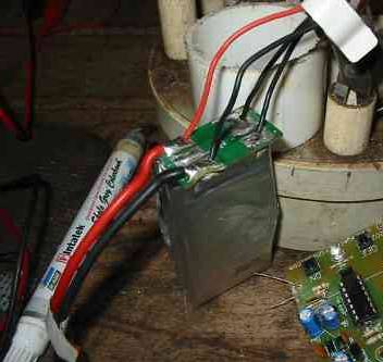

This is a 3S LiPo which would not recharge . On investigation one cell was shorted out. I removed that cell and cut it open for a look.
Now they are in series and the top connector is soldered solidly .Pos to neg of next cell.
Heavy power out leads are at the ends. the red charging wire connects to pos ,the next small black charging wire is to neg of same cell and pos of cell 2, the next small black is to neg of cell 2 and pos cell 3 and the last small black is to the negative of cell 3
So by putting in small cut off wire pieces you can read the voltage of each cell with a multimeter. Obvious for some but I initially had no idea how those charging wires were set up

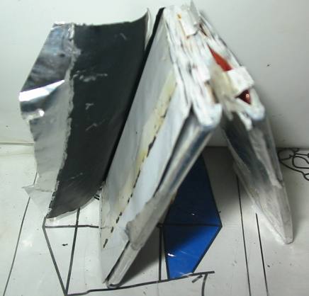

The flat cell I cut open to see a lot of aluminium foil and a black paste layer set up like a capacitor . I tried to ignite the paste but could not . I tried to burn the cell itself with a gas torch to no avail. I crinkled it and dropped it and bent it but it still did not seem to want to catch fire for me !
The heavy terminal material going into the cell was remarkable ,like a metalised plastic strip 1/4 inch or so wide and flat.
I suppose it might have to be fully charged to ignite hey?

Why don't you do a little reading about the batteries and gain some understanding as to why they "explode". Your little science experiment was stupid to say the least, not to mention dangerous. The "explosion" of LiPO batteries is a result of mass pressure release. Ever wonder while you played with a torch what toxic fumes were being released? So how do you plan to now dispose of your little toxic waste pile?

Politics aside, I understand that the Lithium salts (ions) in a Li-Po battery convert into metallic Lithium when the battery is over-charged or over-discharged. Lithium is very active and catches on fire easily. Maybe water on metallic Lithium causes a violent reaction.
It does! A good experiment is to buy some Energizer Lithium batteries, open them up. You will find a rolled up sheet of lithium metal. Be quick and put it into a bottle of mineral oil because it oxidizes quick with the air otherwise. Snip off a bit and stick it in some water. Small amount will fizz and bubble, bigger amounts will burn and possibly have a small explosion. Were gloves always, and do this outside!!!
Pollution, policemen, do gooders and explosions...I don't see the connection.
I hope you did it outside at least. And the cells don't ignite so much as they explode (at least when sealed enough to build up pressure ) which makes rather careless to take a torch to it unless you had a way to be pretty far away at the same time.
It's possible that the cell was discharged enough that being shorted out did not cause it to ignite while completly emptying it leaving little energy left. After all, standard Lipo disposal is to completely drain the LiPo over a long period of time at low power before disposing.

On the pollution side in fact what was a 3 cell pack has now been converted to a working 2 cell pack so rather than disposing of my battery pack I have in fact recycled it !! Only the damaged cell had to be disposed of . Interesting on the energiser lithium cells and bits of lithium , must try that . I will remember to dispose of the water properly if I can just find some way to inject it into my nasty neighbour .
