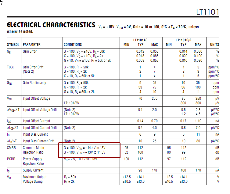

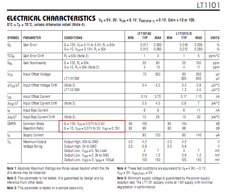

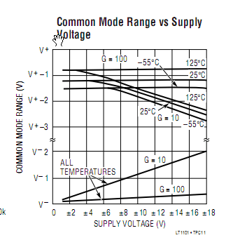

Look at these two images from the d/s, one is for a 15/-15v supply and the other for a single 5V supply

If you extrapolate the limits for the 5V supply and the dual, it gives a value of approx +Vss-2v and 0V + 0.7v
Look at the 3rd image graph I posted for a dual
So I would expect for a 12V supply a CMV range of approx +10V and +0.7V.

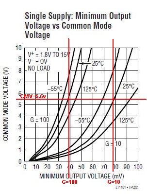

Thanks that is helpful . I dont have a circuit yet but only analyzing the possiblity. I am getting a diferential signal from a force sensor which shows a common mode signal of 5.5V and more.
The above image further explanes it . Does minimum CMV vs O/P voltage means that it can sustain an 'x' output while having 'y' as CMV at its input?

I have marked the graph for CMV versus output voltage at G=100 and G1=10
With a CMV of approx 5.5V and a 12V supply you are well within the CMV range and the amplifier should work OK.
With respect to the output swing, its dependent upon the output load.
If the lower output limit is required to work to a 0V level, then a dual supply is required.
