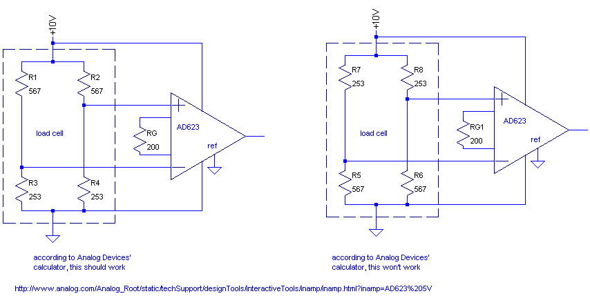

Hi, this is a very low-level question, but I am not much of an Electrical guy, so please bear with me.
I need to increase the signal output from a loadcell. I would like to use a 10v powersupply used on the loadcell to operate the opamp circuit. I have found some good differential op-amp circuits, but am unsure of what to use for vcc & ground...
Also, what opamp would be good for this application? (10mV full scale need to increase to 5V full scale...)
Thanks for any help you can throw my way!!!!!
All the instrumentation op amps are potentially bad for offset because the offset depends a lot on resistor value matching. An actual instrumentation amp chip is much better.
What to use for Vdd and ground?? Whatever voltage the spec sheet says. The spec sheet will also say what acceptable input voltages are in relation to Vdd/gnd.
It is also desirable to simply have a differential ADC going to a microcontroller.
What kind of load cell do you have? Can you provide a part number? The IA choice may depend on what you have.

After I recommended the AD623, I found this calculator.
From the "input resistance" and "output resistance" specs of the load cell, I also calculated what I think the load cell looks like (what a pitiful datasheet). The attached schematic shows two possible orientations for the load cell (note the positions of the resistor values). Either fits the "input resistance" and "output resistance" specs. Hopefully, you have a choice as to which way you orient it. Some of the resistor values will change slightly as the cell is loaded.
I picked this amplifier because it has rail-to-rail output capability, meaning it will go (almost) to zero with no load on the cell, without requiring a negative supply. It is also very inexpensive, and seems to have pretty good specs. You may have to add a post-filter if the output noise is too high.
You can also shift the output "zero" point by connecting the REF input to a reference voltage (don't use a potentiometer unless you buffer it with a voltage follower).

What do you mean by "monitor its accuracy with a pic"? You could certainly convert the output to digital with a PIC, and display the results on some sort of display, but you'll need to get help from someone else (Nigel?).
