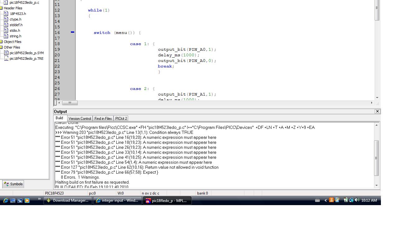

the compiler points to the top line of this code :
-> int menu(unsigned int)
unsigned int ch;
printf ("\n\r Press A to turn LED on RA0 .......");
printf ("\n\r Press B to turn LED on RA1 .......");
printf ("\n\r Press C to turn LED on RA2 .......");
ch = getc(); //wait for and get serial character
delay_ms(100);
return ch;
/// And the error messages i get are these
Executing: "C:\Program files\Picc\CCSC.exe" +FH "pic18f4523ledo_p.c" I+="C:\Program Files\PICC\Devices" +DF +LN +T +A +M +Z +Y=9 +EA
>>> Warning 203 "pic18f4523ledo_p.c" Line 13(1,1): Condition always TRUE
*** Error 51 "pic18f4523ledo_p.c" Line 54(1,4): A numeric expression must appear here
*** Error 127 "pic18f4523ledo_p.c" Line 62(10,16): Return value not allowed in void function
*** Error 79 "pic18f4523ledo_p.c" Line 66(57,58): Expect }
3 Errors, 1 Warnings.

hi ,
i edited it as you have pointed out , now the error is on the line where its returning the value .
i have attached the screen shoot .
You are getting that error because menu requires an integer passed to it. However, your menu function doesn't use the parameter that is passed and so you may as well change it back to void.
