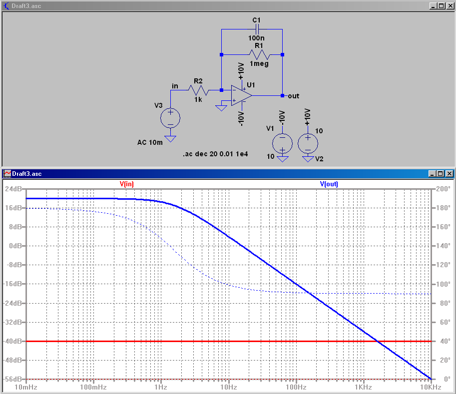

I tend to think of it this way: At low frequencies, the gain of your stage is -Rf/Rin = -(1e6/1e3) = -1000 = 60db. At some frequency, the Xc of the capacitor is equal the feedback resistor, 1meg. Below that frequency, the gain is determined by the feedback resistor; above that frequency the capacitor dominates, and the higher the frequency, the lower the gain. At the frequency where Xc = Rf, since the two are in parallel, this reduces the gain by half, or -6db.
Rf = 1e6 = Xc = 1/(2ΠfC) = 1/(6.28*f*100e-9)
Solving for f; f = 1/(6.28*1e6*100e-9) = 10/6.28 = 1.6Hz
So below 1Hz, gain is 1000 (60db); above 2Hz, gain falls off at 6db per otcave.
Let's see how we do: (see attached)
Note, gain at low frequencies is 60db (from -40dbV to +20dbV).

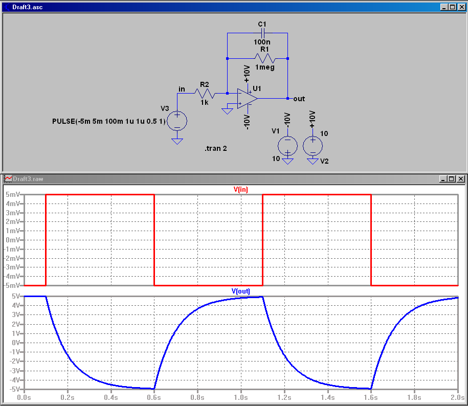

Now look at the circuit again in the time domain. Notice if you wait long enough, the gain is 1000.

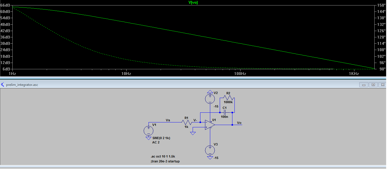

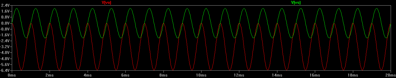

But when you consider it as an RC filter with gain function you get the right value for the gain. But in that equation its missing that the output signals at offset, as seen on the curve. When you integrate the curve you get the ryt equation with the offset but wrong gain :confused:
i uploaded the curve i got for the output.. can you explain how to get that curve mathematically.. :( im running out of time
2hours eta :(:(
That is a time domain response where the input frequency is such that the gain is only about 2. If you look at the frequency domain response I posted, look where the gain is about 6db (~800Hz). Note that the phase shift from input to output is in the flat region where the phase shift is 90degrees. This is the region which is a long way above the corner frequency, so the response is that of an almost pure integrator (i.e. rolling off at -6db per octave, and exhibiting a phase shift of 90 degrees.
i understand that.. thanks :) but my homework problem is to get the time domain equation for the output at 1kHz.. therefore i need the equation for the red curve in my diagram :(
and the frequency domain response i got is a different.. although i did get a gain of around 3 at 1kHz at that bode.
a quick response would be highly appreciated :) 1 hour ETA :confused:

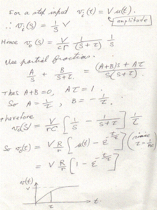

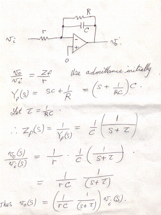

I would use Laplace transforms. That is much easier than solving Differential Equations.
Here is the Laplace method for a step input.
Note that it is not an exact integrator due to the presence of the feed back resistor R.
I'll leave it to you to do it for a sine input.
I also suggest that you repeat the maths with R removed.
Then, for a step input, the output v(t) will be a ramp rather than an exponential.
Note that the exponential approximates a ramp initially.
Also note that the gain at DC & low frequencies is R/r as you would expect.

The gain is written at the bottom of the first page, ie. Vo(S) = ...
There is no offset since I have assumed an ideal Op Amp.
And in the time domain result, the gain is R(1-ε(-t/τ)/r
And as t > ∞, the gain > R/r
no no im not asking about your solution.. unfortunately i still didnt have time to go through it :(
lets say a voltage of 2sin(2000*pi*t) is applied to the above circuit..
when you multiply it by the magnitude of the transfer function and add the phase difference you get
Vout = -1.59*2sin(2000*pi*t-90)
but when you do a time domain analysis.. as in when you consider the voltage across the capacitor and integrate it over time you get
Vout = -(some_gain)*2(cos(2000*pi*t) + 1))
so as you can see this signal is going to be an offset of its amplitude due to the +1 part of its equation.. which is the case for integrating op-amps as shown in the simulation curve. but unfortunately the (some_gain) i get here is not equal to 1.59.. which is the correct gain according to simulation.. :S
and in the first method using transfer functions i get the gain of 1.59 but not the offset..
so for my prelim i just substituted 1.59 inplace of (some_gain) and the answer was correct! :D hehe but i dont know how to derive it mathematically.. unless you do both analysis and combine them

Attached is the solution for a step function solution - it may give you a clue as to what your problem is.
