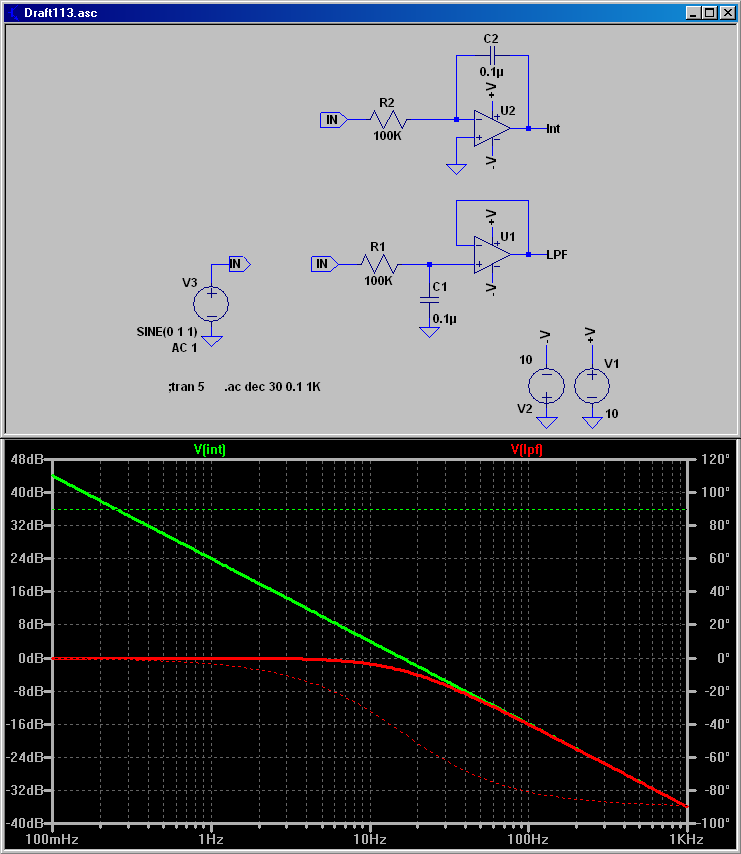

I am a little confused with the difference between high pass filter and differentiator,and low pass filter and integrator.The frequency response of differentiator,HPF and integrator,LPF are nearly same.
So what is the difference between them?
Still think they are the same?

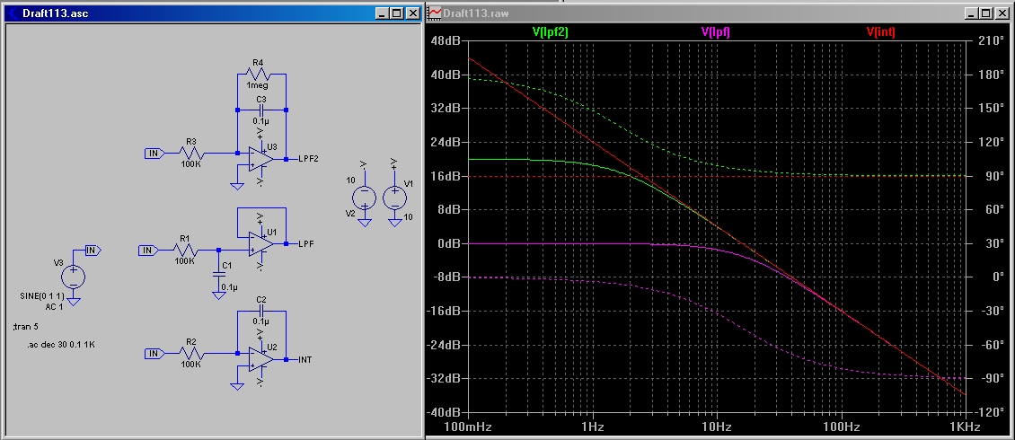

However, that is no longer an integrator, it has become a low pass filter with a fixed gain in the passband with the addition of the resistor in the feedback path.
I'd call it a "Low Pass Filter with a gain of xxx".
