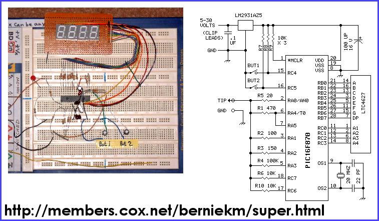

I would like to recommend the following to anyone interested in making something nice with a PIC. The image shows the schematic and the actual probe built on my breadboard.
It is a probe with 16 functions which includes:
- Logic Probe
- logic pulser
- Frequency Counter
- Event Counter
- Voltmeter
- Diode Junction Voltage tester
- Capacitance Measurement
- Signal Generator
- NTSC Video Test Patern
- Serial Port tester giving out Ascii characters
- Midi Note
- R/C Servo tester
- Sqaure Wave generator
- Pseudo Random Number generator
- ir38 infrared red LED driver
- PWM waveform output (6KHz, 3% to 97% duty cycle)
As you can see, the schematics is very simple and no additional transistors or ICs required. I use a 16F876 and programmed the hex code by the author into it and it work as expected.
The author has also provided the source code to the project so one can learn the technique in implementing the different functions using PIC.
There are also other PIC projects in the above website so you can look around. Most of them have schematic, object code and source code for download.

Prety nice!
All that whith almost nothing but an PIC.
Wen i seen the feture list i toght: Oooo this must be a huge circuit.But i lost my words wen i seen the schematic.

that is awesome :) I even have one of those exact same radio shack logic probes at home that I could gut to build it in!
However, I'm very tempted to modify it to use an LCD instead, as I have some nice tiny little 2x8 character LCD's I can use...
just what I needed, another project... as if i had any free time left to spare :lol:
You could even get away with using a 16F88 (my fav) instead of that big chip. If you minimize the pins needed for display by doing an LCD in 4-bit mode.
Uhhh...scratch that. I counted again.
Mike
I've been looking at this project for some time now, and as soon as I have a little free time I'll be building one in a RS logic pulser case that I just don't use (same case as the logic probe).
But I will probably try to use a hdsp-2112 display that I have laying around here. Too bad I can't find any asm code to drive this display, would have saved alot time when modifying the source code. The only problem with this display is that from what I can see, I will need 13 I/O pins to operate it. I did not read the Datasheet yet but I just might be able to pull it off with alot of tweeking. :)
Note:
If anyone wants to build the probe and have difficulty in get the display, you can use any commom anode 7-segment LED displays with decimal point, like I did in the picture.
I am fairly certain(but not 100% as it is not tried) the probe will work using any PIC from the 16F87X or 16F87XA series so you don't need to find/buy the particular PIC used by the author.
Have fun and modify the project to suit your needs. My take is to modify it to give a mode which shows me the HIGH time and LOW time of a rectangular pulse.

The original super probe uses common anode 7seg display's .. I got request from a friend to make changes in the app so that he can use common cathode 7seg's.
Here it is, use exactly the same schematic as on Super Probe only abcdefg and dp are anode and rc0-rc3 go to C1/C2/C3/C4 (common cathode)
Attached, mplab asm and hex file
EDIT: attached proteus7 dsn file

I built the contraption last night (when I finished the code for a friend) to try it in real life .. not sure if the buttons I used are bad or no software debounce exists (I just traced the portc use and reversed it so it can be used with common cathode 7seg's) but the device is completely useless .. will try to add some hw debounce after I change the switches .. maybe that's the problem ... also, it always get stuck in coil and capacitor measurement :( (the original one, not the changed one) ... but anyhow - interesting project :D
I have programmed asm for various chips but have not done anything with the PICs at that level. I can read it enough to figure out what it is doing and thats about it. Sort of been there, did that, not point in doing it again. :)
Fixing the coil and cap hang would be good. Also the 16F870 is getting old and expensive. Maybe time to move the code to a more modern maybe faster chip. While we are blue skying I would like to see a autoranging ohm meter function :)
That's what I'm thinking since yesterday :D ... I also tried out some interesting 24F chips .. and have few small dsPIC ones too (I have dspic33fj12nc202 28pin trough hole that I never took out of the original packaging .. have no idea why I ordered it) ... IIRC those are all 3V low power ... should be interesting to make autoranging, very precise, very fast, ohm meter ... (yeah I do believe dspic / 24F might be overkill .. but, why not .. maybe some 28pin 18f with ad's)
