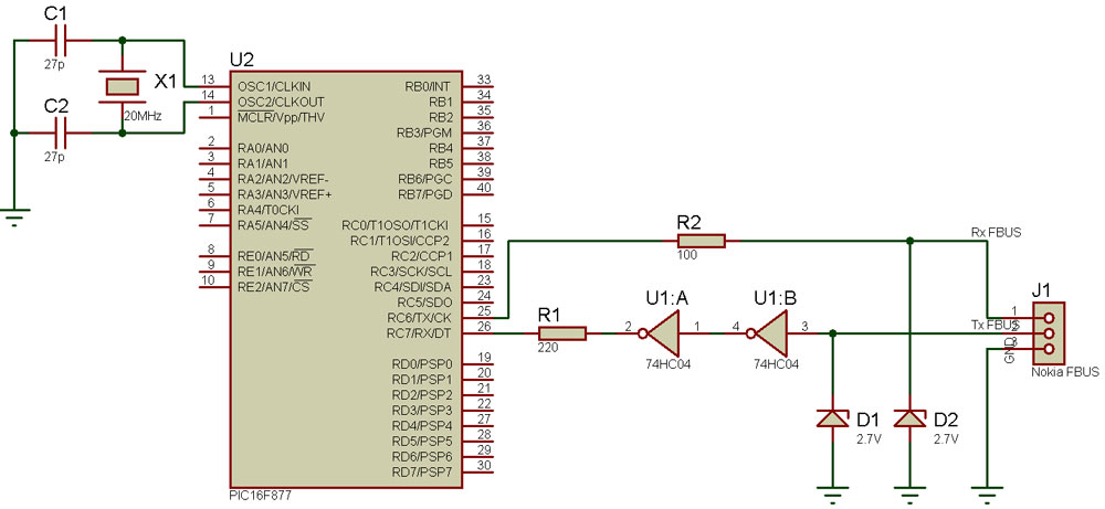

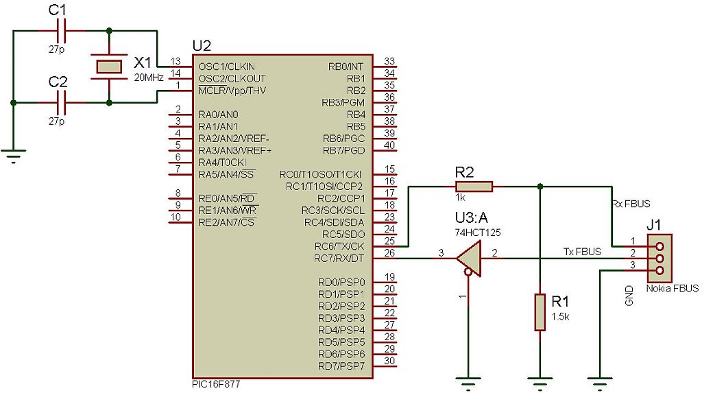

Hello everybody. I would like to interface PIC with a Nokia mobile via FBUS to send and receive SMS. I have collected two schematics. Which one do you recommend? Is there any enhancement need to make?
Thank you.
