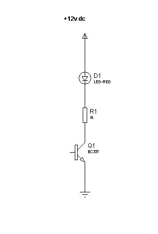

To check things, go back one step and test the pic and transistor work ok with a led.
