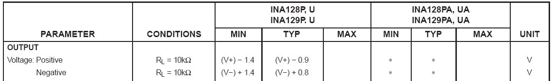

I used a -5/+15V supplies and it works great. Another question, if I knew the only input voltages that I would see were between 0.6 and 1.0 and I set Vin- to 0.5 then at G=10, my output would swing from 1 to 5 volts correct? How high will the output of the INA128 go with a +15V supply? 13V?
See attachment for the area of the datasheet that tells you the limits of the output voltage. WHen selecting amps or op-amps, some of the first things you should be looking at on the datasheet are the supply voltages (as well as unipolar or bipolar supply), the input voltage limits, and the output voltage limits, all of which you seem to have missed when initially designing your circuit.

Yes, it will amplify the difference between the inputs since it is a differential amplifier (and is also true for an amplifier with a changeable bias/reference, but there is a subtle but important difference with how common-mode signals are treated and I won't get into it).
