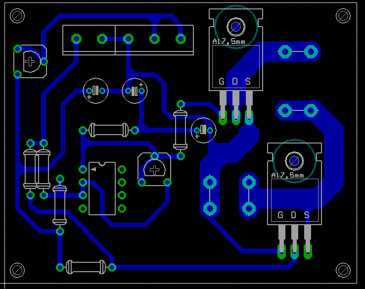

I now have my 12V thermosat schematic ready for board design. While thinking about the PCB I got to thinking about the track width. I expect to be switching about 16A through a Mosfet. How does one interface the high current carrying leads with the PCB. I was hoping to use PTR Connectors AK500/2 and /3.
What confuses me is the following;
- theortically I need about 6,5mm², (from wire tables) this translates to a track width of ~ 162mm?
- Why if I need 6.5mm² are the legs on the Mosfet barely 1mm².
Evidently I am missing something here, could someone point me in the right direction?
Cheers
Andrew

hi Andrew,
Look at this pdf, pages 6,7
You can 'beef up' tracks by soldering onto them a heavy gauge tinned copper wire or copper braiding. [recovered from old coaxial cable screening]

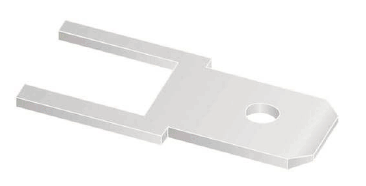

Hi Andrew,
keep the traces as short as possible and use flat male connectors (females are crimp connectors as used in car electric)
Here is a picture of one to be soldered onto a PCB.
Boncuk

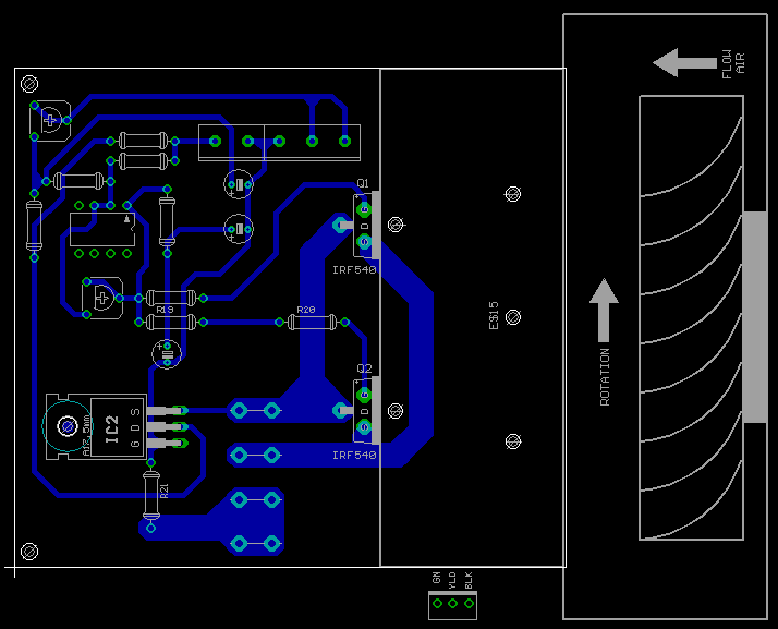

Here is the board, the two T220 packages will stand vertically and the 540 will be heatsinked. Is it OK, the screw connectors I am unhappy with and like the spade terminals.
Cheers
Andrew

Hi Andrew,
as far as I know mounting tabs of that kind are not contained in Eagle.
Standard tabs are 6.3mm. I made a quick library for that one.
Try to get long ends to be bent opposite underneath the PCB for maximum mecanical strength. The females fit very tight and it requires quite some force to separate both parts.
The screw head terminal you used in your design doesn't look like it can stand high current. If neccessary use two mounting pads each for one connection and also use two wires in parallel (total of four)
Regards
Boncuk

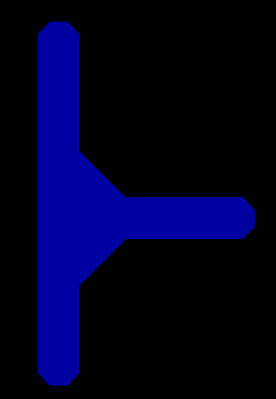

P.S. One hint concerning PCB layout: Avoid right angles and route 45 degrees. At T-junctions add manual traces to meet the junction at a 45 degree angle. When done, check if all elements have the same net name. Click "show" and all traces must be highlighted. If not, check for different names and rename the unconnected trace accordingly. Check for air wires after renaming and reroute.

Hi Boncuk,
thanks for the advice. Will redo the tracks.

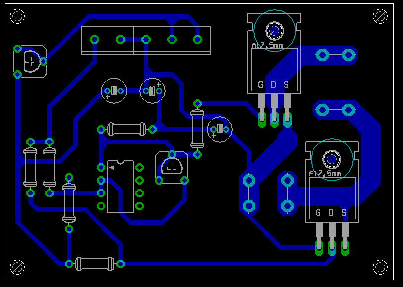

Hi Boncuk,
is this new board getting closer? I have not put the spade terminals in as I am unable to open the Zip file yet.
Cheers
Andrew

Hi Andrew,
looking much better! You might route the trace from the right bottom connector terminal to the heater connector around the screwhole of the IC.
I zipped the file using 7-zip, but it should open using winzip. Did a double click not unpack the file?
It does on my PC though.
You can download 7-zip free and retry.

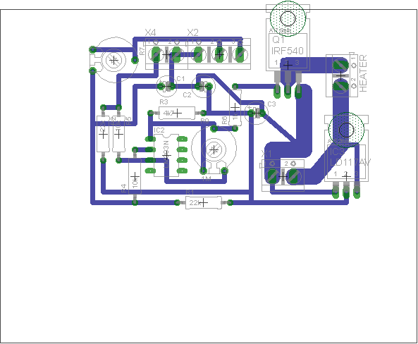

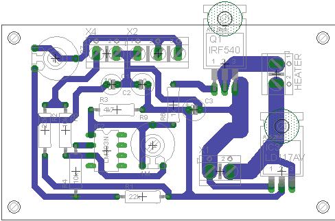

Here is what I have done to your design.
The third image is the same design shorted by 10mm.
Regards
Boncuk

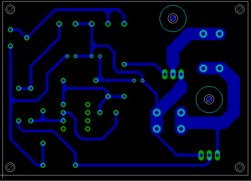

Hi Andrew,
here is a suggestion with two parallel IRF540 (not the best choice).
It uses an outdated Pentium IV heatsink with fan. If necessary you might place three transistors on that heatsink.
3 resistors are added: R19 is a gate resistor for the second transistor and R20 and R21 are zero Ohm resistors instead of wire jumps.
Boncuk

Hi guys,
this is all great info thanks.
Boncuk,
a) you said this is not a good choice, I assume you mean the choice of Mosfets rather than the fact that they are paralleled? I happen to have a P4 heatsink and fan combo waiting for a job. Any suggestions for the Mosfets?
b) I don't mind whacking 4 Mosfets in, there is lots of space where this is going. If I used 4 would probably take them offboard and arrange around the heatsink in a North, E, W and South arrangement with a ringmain connection
c) what drawing program are you using?
d) on the gate resistors, based on your comment one obviously needs one per Mosfet? I have been trying to teach myself electronics with LTSpice, playing around with values etc. The one 390R resistor feeding 4 Mosfets gives the same output trace, what am I missing here?
