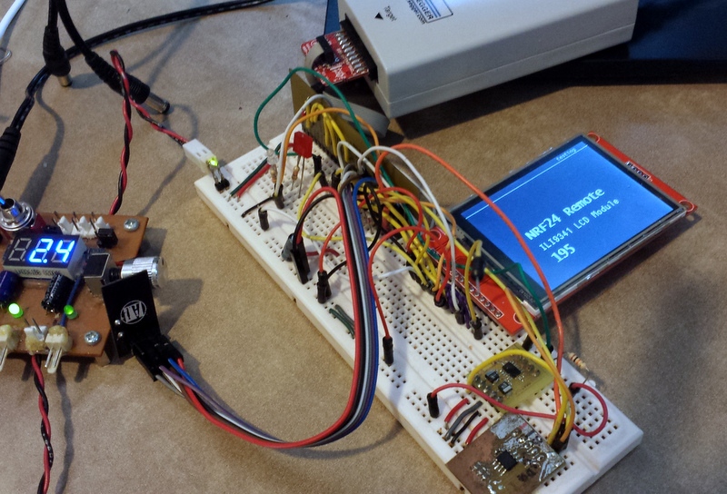

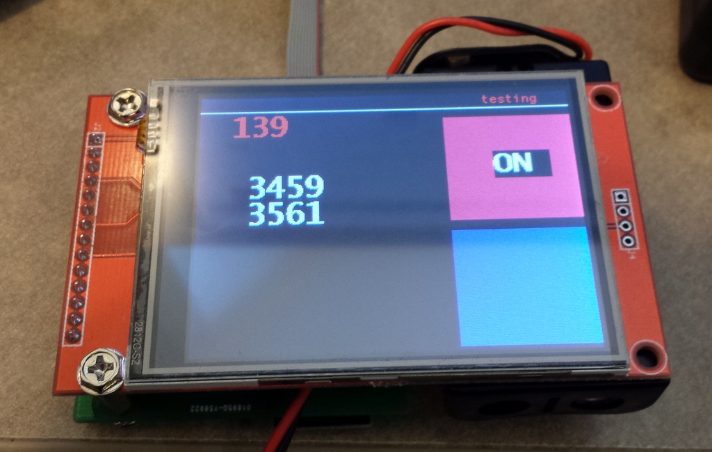

I love these displays. They are my new favorite display. Easy to use and very readible. The touch is a great feature as well.
I do not need to worry about level shifting and I generally use 3v3 uC's so I can't really help you there.
Driving the SPI as fast as I can with 16bit writes on a 48mhz processor I can get a fairly quick full screen refresh. I might be able to get a little faster DMA'ing the data, but I haven't taken a hard core look at optimizing the speed. Just looked at a refresh and I would say about half a second for a full screen write.
I use both the touch and non-touch ones. The touch controller is a clone of an older chip that I used to use, so I use the drivers for those I made a long time ago. The SPI is strange and I've only seen software versions of it.

I'm using ARM Cortex M0 or M3 processors. I don't think I've tried it with anything else. The one in the picture above is a 2.8" module with a small board on the back with an LPC1114 on it.
In testing I have driven the LED directly with 3.3V or with a p-channel mosfet controller by the uC. In the two final designs I did with it both use the mosfet so I can turn off the backlight. One is the remote above and I have to turn off the light and put it in sleep mode when it's not in use.
I do have the MISO line connected, but looking through the code it doesn't look like I use it at all. I have other things on the SPI line so I need that pin anyway and it's just connected to the bus, but it doesn't look like it's needed for the display.
