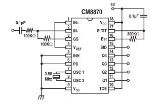

I graduate this summer i was working in the same project as Osama mintione mobile control i make a similar project but i have a problem with the ic i used its the same as yours MT8870 in this you can see it in my web **broken link removed** i used it for home phone to test it but the problem that i have is : the ic can't detect the frequency of (or the numbers )12347 and * ,its works for just the first time and then it have this problem, i tried to change the ic for 4 times and still have the problem is there another ic to detect the tons or asolution for it.
Replace the two 5.6V Zenners & place two 1N4148 back to back diodes there.
Your input FILTER caps ok (0.1uF). But if you change that you will see some different.
Sometimes when checking the steering LED (STD) it won’t (go high) detect a valid DTMF tone pair but the tone can hear from the receiver. So micro cannot detect the external interrupt occur signal.
Earlier there were complaining from customers, the SECURITY PRODUCTS they bought for there houses can activate from any phone by calling & dialing some numbers to there home land line. It uses this same old IC.
When they activating their security systems by mobile phones it won’t activate anymore.
Specially the low frequency pair buttons 1, 2, 3. So they won’t recommend mobile phones to this DTMF circuit.
But we need wireless ones :D
what about taking the input from the speakers line
like in this schematic.
can it solve some thing or still the same prob
