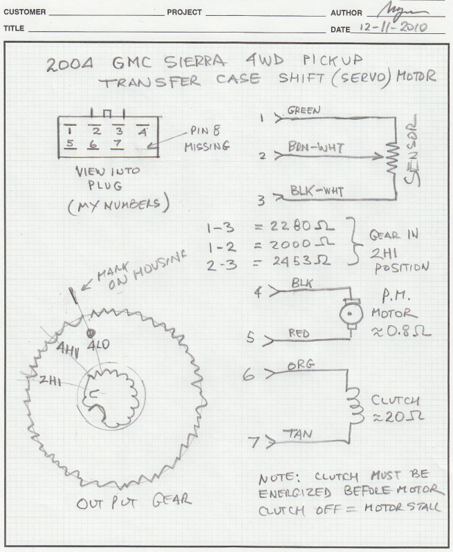

I then disassembled the TCSM on the workbench as per the instructions. Without moving the output gear, I marked the position of the dimple on the output gear on the housing. Note that mine came off the truck in the 2HI position. My reasoning was that the position of the rotation sensor attached to that output gear is critical so I wanted to be able to reinstall the gear/sensor in the same position. Note that there is a | mark on the gear housing, but that did not align with the dimple in the 2HI position; I am guessing that it would align in the 4LO position, more on this later.
Next, I traced out the wiring diagram of the TCSM as shown in the attachment. I then used an Ohmmeter to measure the resistances as shown in the attachment. Note that there are three things inside the TCSM; A reversible DC motor, a DC powered clutch, and a resistive potentiometer rotation sensor. This is very useful information; I wish I had it before I started... I recorded the sensor resistances before disturbing the gear/sensor. Lo and Behold, as I started making the measurements, the path from the Brown-White wire (Pin 2, sensor wiper) to either the Green wire (Pin 1) or the Black-White wire (pin 3) was open. The resistance from the Green wire (1) to the Black-White (3) wire was 2280 Ohms.

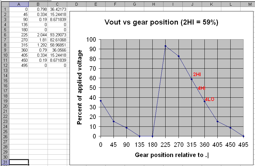

I proceeded to record the resistance vs the gear rotation. However, I noticed something weird about the measurements. The sensor resistances are unlike any pot I had tested before, in that the sum of the resistance from the wiper to either end does not add up to the total end-to-end resistance. With the gear in the 2HI starting position, the resistance 1-2 was 2000 Ohms, 2-3 was 2453 Ohms, while 1-3 was 2280 Ohms.
I guessed that since this is used as a rotational position sensor, the TCCM puts a fixed voltage between 1 and 3, reading the voltage at pin 2. I applied a fixed voltage of 2.2V from 1 to 3, while measuring the voltage from 2 to 3. The second attachment is a plot of Vout vs gear position. I used the | mark on the housing aligned with the dot on the gear as the 0 degree reference, and turned the gear clock wise. There are eight holes in the gear, so it was easy to record the voltage out every 45 degrees. I converted the output as a percentage of the applied voltage. It is possible to turn the gear forever, so I went more than 360 degrees.
Note that at the 2HI position, the Vout = 59%. The 4HI position is approximately 22deg CW from the 2HI position, and 4LO is about 45deg from the 2HI position. In other words, the 2HI position is about 45 CCW from where the . aligns with |
I ran the motor, by connecting 12V between 4 and 5, and discovered it is necessary first power the brake (clutch?) 6 and 7, other wise the motor is stalled. The clutch/brake is likely used to suddenly stop the motor from coasting past the indexed position while shifting from 2HI to 4HI to 4LO. I haven't tested this, but I'm guessing that if either the motor or clutch windings were open, the TCCM wouldn't pass the wake up test. (Likely different trouble code, but same symptom as the open sensor wiper)

thanks mikeml for sharing so much info on this sensor, just as you did i marked my housing where the dot was on the output gear,according to your ohm readings mine read that it was in 2hi as i thought it was.My ohm reading between 1and3(your numbers) 2280 does not change no matter where i rotate the sensor. Is it supposed to? and do you know the ohm readings for 4lo and 4hi? thanks again,lonny.
As long as terminal 2 is open circuit, then the resistance from 1 to 3 will not change as the gear is rotated. The readings from 1 to 2, or 2 to 3 will change as the gear moves.
I didn't happen to record the resistance in the other positions, since I knew my transfer case was in 2HI when I removed the servo. I was mainly focused on getting the gear back into the right position... I'm guessing that if you assemble the servo with the gear one tooth off, then the system will not work, but it may work if you have the dealer "reflash" the TCCM. That would reset the decision points...
The graph I posted shows the %voltage out as a function of gear rotation. Hook a 1.5V D-cell battery between 1 and 3, and measure 2 to 3, convert to a % of 1.5V, and you should be able to position the gear at either 4HI or 4L.
