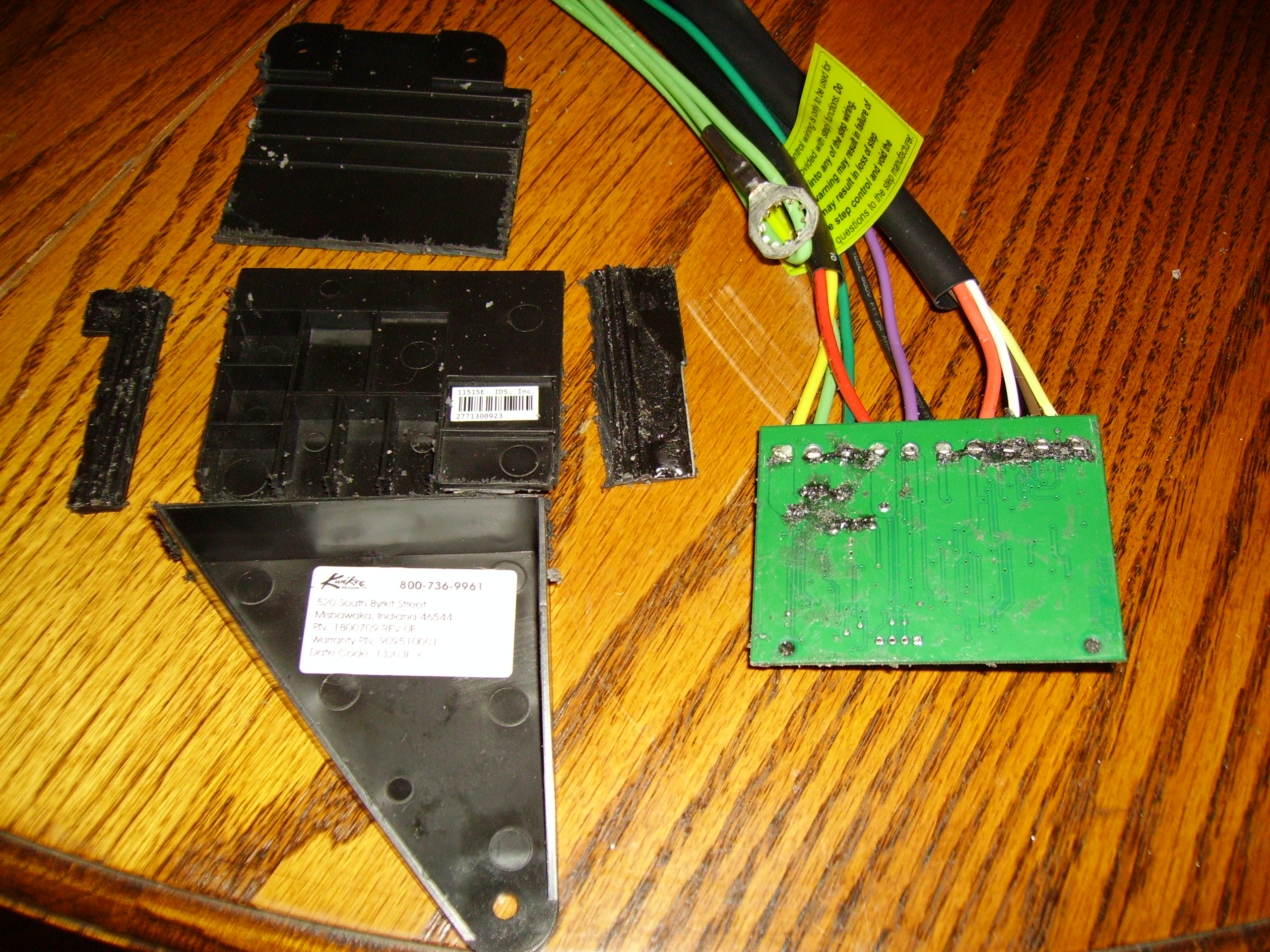

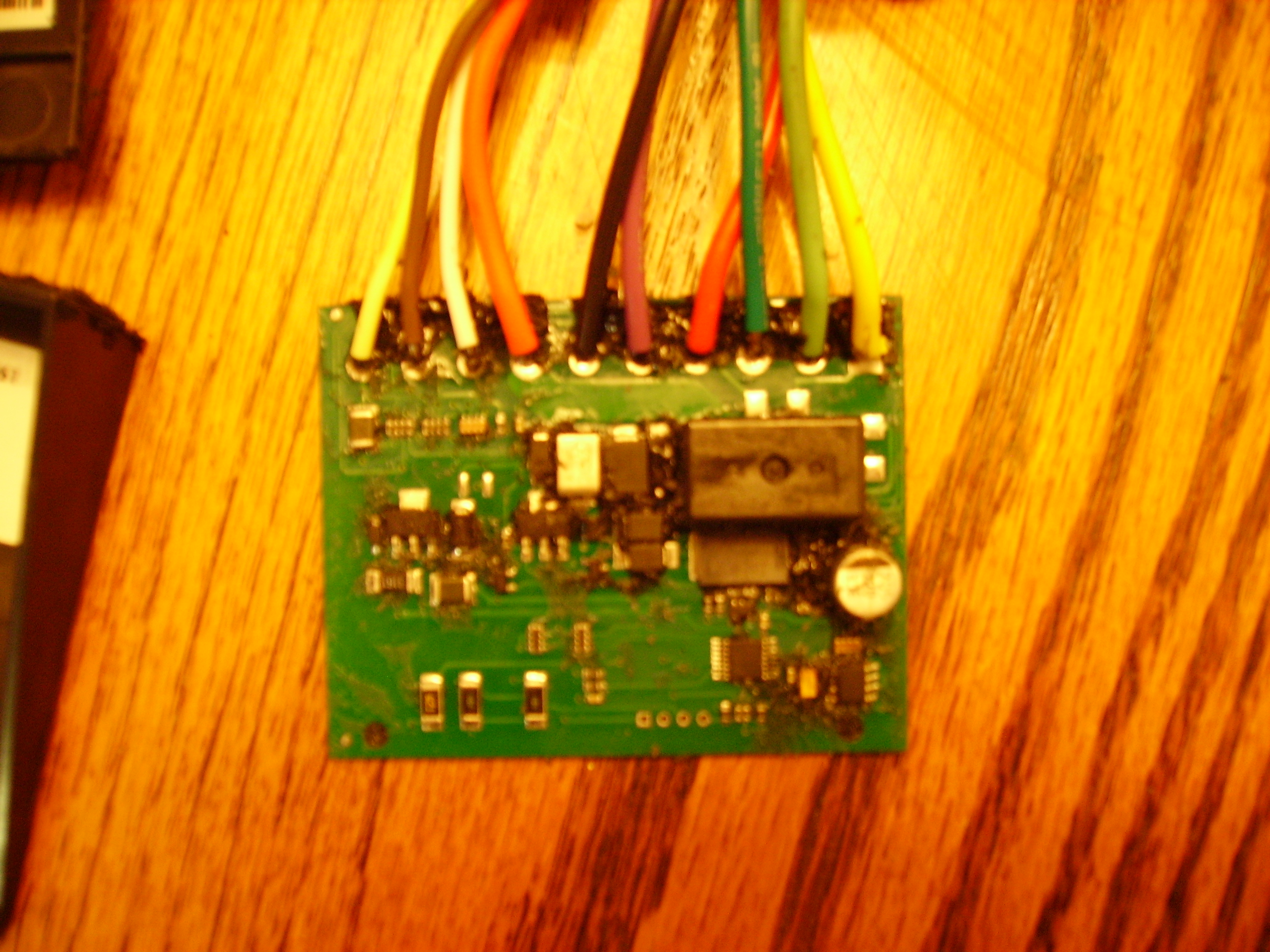

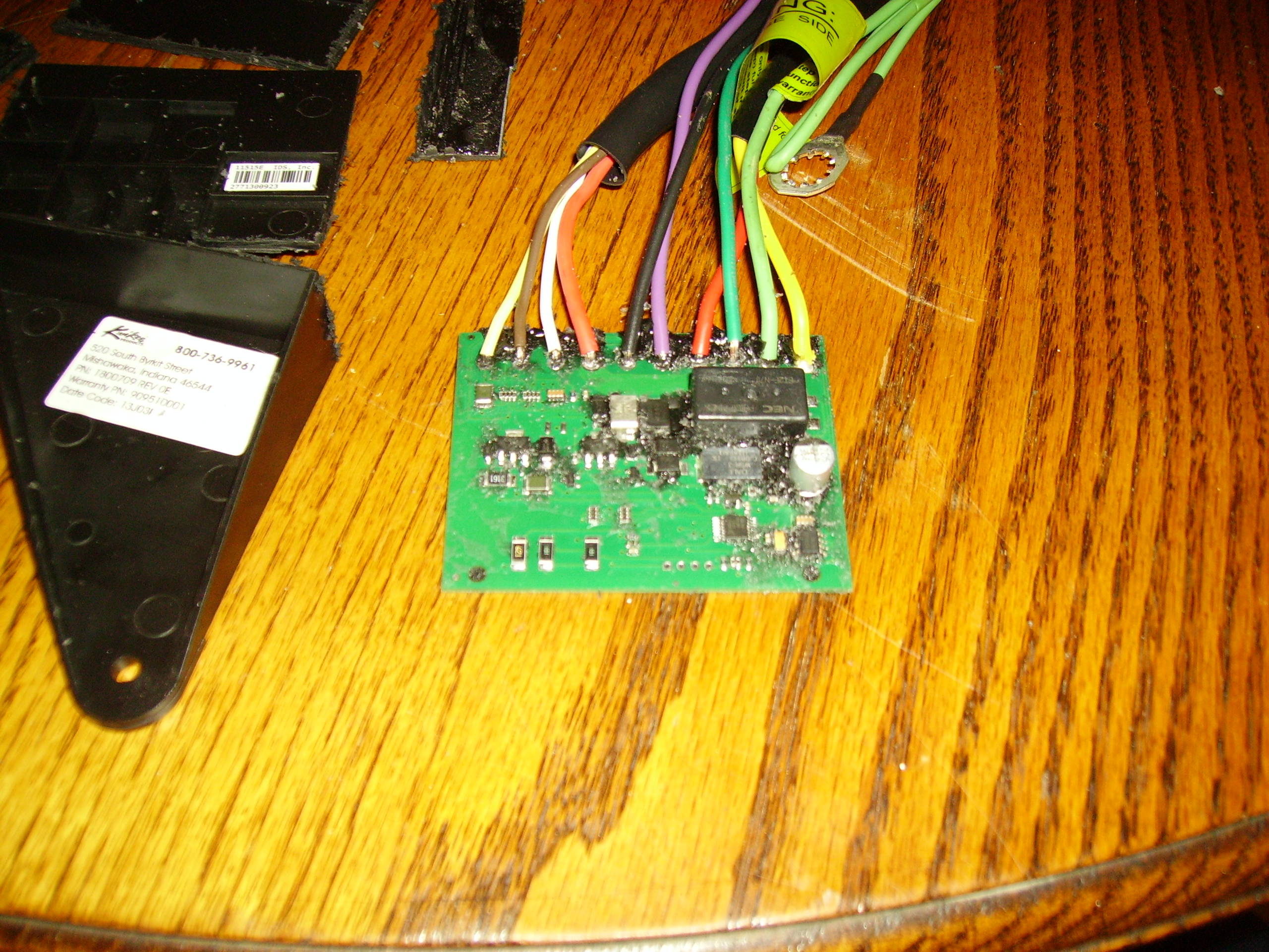

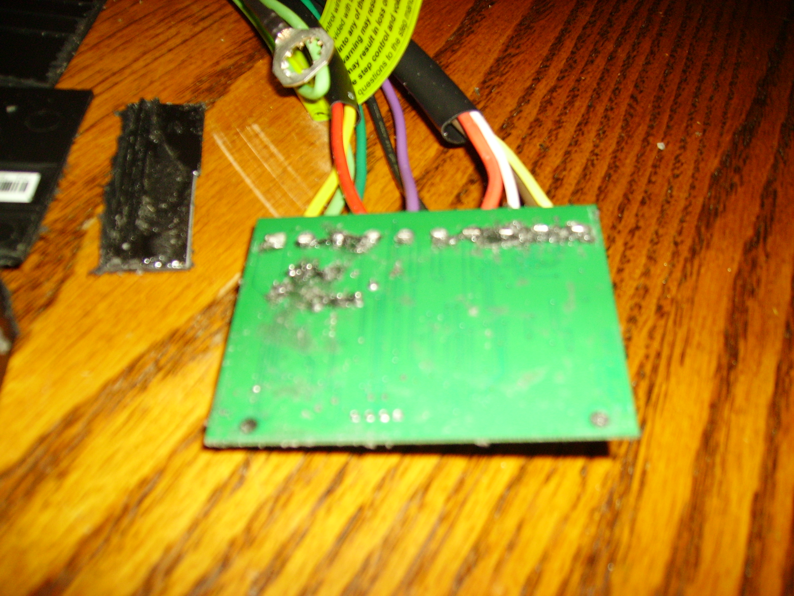

Well, I ordered and got one of these control modules. I carefully took it apart. It was filled with a silicon type of epoxy, flexible not hard. Upon disassemble I immediately realised that I would not be able to reproduce this unit because of the complexity and the fact that it's all micro circuitry. I did find this on the circuit board: IDS, Inc. 11077-D.
Here's some pics:
