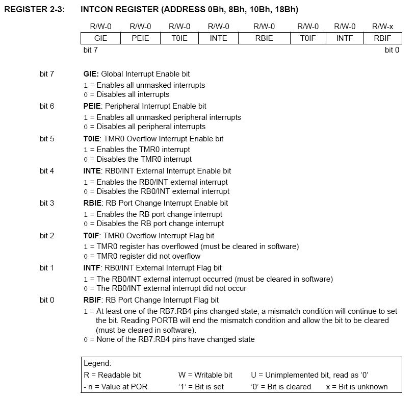

2. The other option is to use the Change in portB interrupt. According to the datasheet:
An input change on PORTB<7:4> sets flag bit RBIF
(INTCON<0>). The interrupt can be enabled/disabled
by setting/clearing enable bit RBIE (INTCON<4>)
(Section 3.2).
But this will allow you only 3 switches to cause an interrupt so you still will need to OR 2 swithces. [CORRECTION: THAT IS 4 PINS SO NO NEED FOR OR CHIP]

what is the meaning of 'INTCON 0.1 = 0 '? is it used to clear the bit0 and bit1 in the INTCON resigster?[/quote]

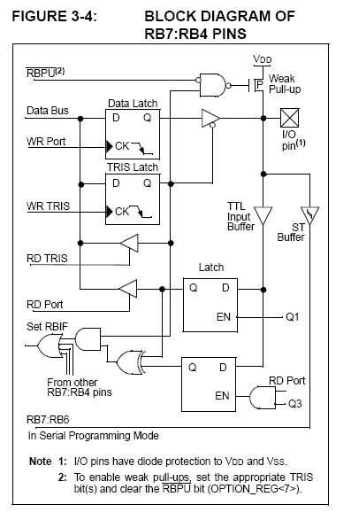

can anyone explain to me the meaning of the following sentence?
(1)The input pins (of RB7:RB4) are compared with the
old value latched on the last read of PORTB. what is the meaning of the 'Last Read'?
(2)'Any read or write of PORTB. This will end the mismatch condition'.
what is 'read or write' mean?is it when i configure the pin as an input (using TRIS register) by writing the register a binary 1,that is called write?
and when i use the command (PORT<x>=<?>, that is called read?[/quote]
Let me see if I can address some of your questions
the port b has weak internal pulllup when configured as input, do i still need an external pullup?
You aren't going to need a pullup resistor if they are enable.
For this part you will need to follow me to Fig 3-4 on the PIC16F877 datasheet CK DIAGRAM OF
RB7:RB4 PINS
You can follow what happens at each pin in RB7-RB4. To read is to move data into the PortB register. Unless you make a command to read the PortB you will never know what is there. You can read ports by assiging them to a variable or by reading the actual port like this
Switch1 = PortB.1
If PortB4 = 1 then ....
Switches = PortB
What ever it was that you read stays latched "remembered" to compare against the chages in port. That is why the XOR gate with the two D-flip flops as inputs. (Fig 3-4)
You read an Input..... and write to an output. You use the TRIS register to make a pin an input or an output. And you use the PortB to either read the pins or write to the pins. So if once you get the interrupt you read the PortB register that will clear the mismatch (since the pins read became latch) and therefore clears the interrupt.
Blibala: The 'INTCON 0.1 is so you choose which one bit you want clear. :wink:
Check the attached files.

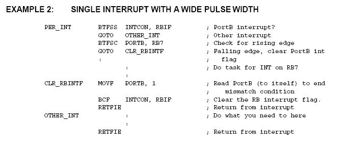

can explan this fopr me? i dont understand how to eliminate the 'false' trigger of interuupt in this program. how this program actually works?
