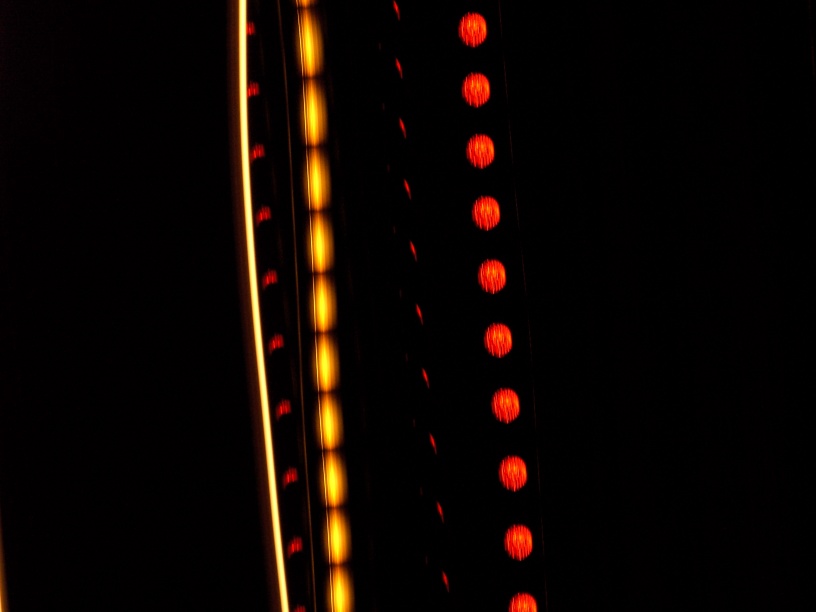

I hope you all realise that 100 Hz flickering isn't visible. If it were, cars like the latest VWs wouldn't be legal..........
The Road Vehicles Lighting Regulations 1989
The photo shows a VW tail light, a street light and a conventional sidelight, all taken with deliberate camera movement. The street light is powered at 50 Hz so it is modulated at 100 Hz. The LED is also flashing at that speed, but much more obviously because it is off for more time.
I can detect LEDs flashing at up to about 600 Hz, depending on conditions. The flashing LED tail lights a real pain.
