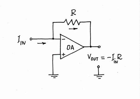

hello forum. i am trying to make a current to voltage converter, that will convert , current produced from a photocell, to voltage.
i know that the simple way is like this :

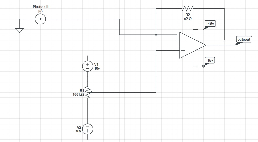

the thing is, that in my circuit, the non-inverting circuit, is connected to a veriable voltage source (-10, to 10 v) , and so , the inverting outpout, is also used, to BIAS the photocell...
in that case, how can i find the Vout of the OpAmp?? thanks allot!!
You need to subtract Vbias from Vout of the I-V amplifier. It takes another opamp to do this.

If you apply a voltage to the non-inverting input, the transfer function becomes Vbias-(I*Rf)
You don't have to bias it there. You can bias with an isolated supply

the output voltage, has to be 1mV per 1pA!! i have also concluded to Vbias-(I*RF) , but i cant seem to be able to use it, since Vbias, will always dominate the output??

the circuit so far, looks like this : (the current source, represents the photocell... couldn't find the correct symbol!

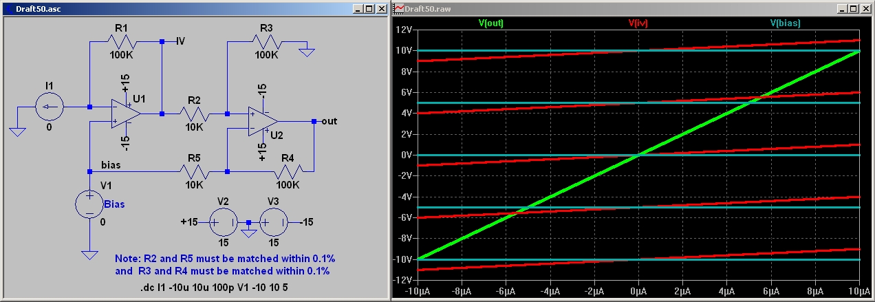

You didn't take the diff amp advise, so here it is in more detail:
For the sim, the current source is varied from -10uA to +10uA as the bias is stepped from -10V to +10V. I put a gain of 10 into the diff amp. You could also use an instrumentation amp to subtract out the bias voltage, and get more gain in the second stage.
Putting gain in the diff amp will give you an overall better noise figure than trying to get all the gain you need in the transimpedance amp.
I'm just curious. The op amp is likely to have some input bias current, which is probably much higher than 1pA (and may be negative too). It is also very likely to change dramatically when you change its "+" input between -10 and +10V. Are you going to calibrate your device to somehow account for the input bias current and its changes over the scale?
You can avoid the influence the cell bias on the output if, instead of biasing the end of the cell connected to the op amp input, you bias the other end of the cell which is currently connected to the ground.

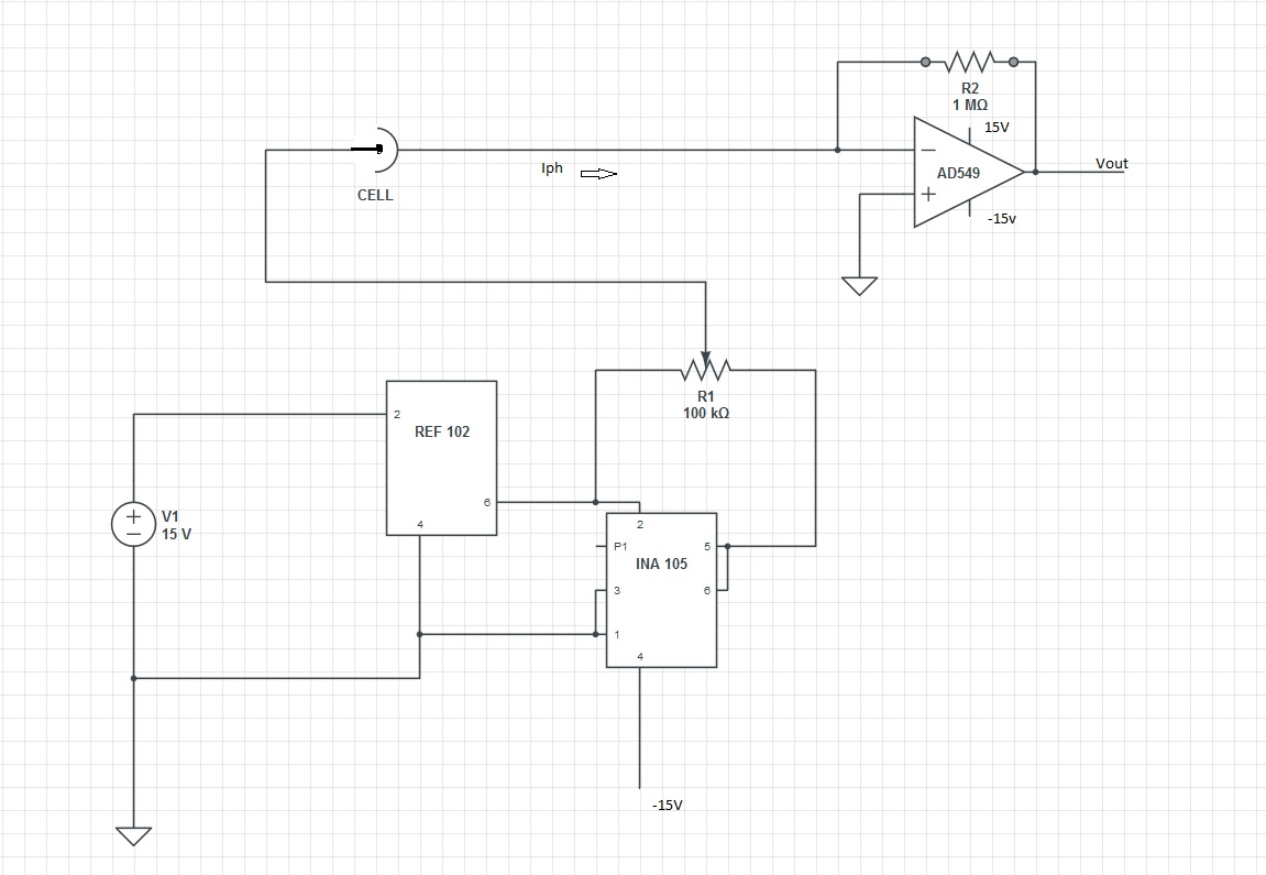

ok. what do you guys say about that circuit??
its supposed to give 1mV per 1nA... my only problem is, if i have bias the photocell correctly....
That will certainly bias the cell. I don't see how you are going to distinguish between Vout changes due to cell current and those due to bias voltage change (noise, ripple) :confused:.

i see. and i suppose, there is no good way, to be aware of that current, without a second op-amp?? (cause if i where to use 2 op-amps, i would go MikeML's way )
You haven't told us the cell spec, so we don't know if the cell current due to the bias is predictable.
Try MikeML's method; but I still think errors/drift in bias may mask the wanted cell output.
There's no way to account for that current at all. You cannot tell if the current you get is leakage current caused by your bias or some other form of current produced by the cell. If you want to distinguish them, you need to turn the cell off (you don't tell us what is the cell, so I don't know if that's possible) and measure leakage current alone. And even then, there's no assurance that the leakage current with cell off is the same as with cell on. If you cannot turn it off, you cannot separate leakage and cell currents.
