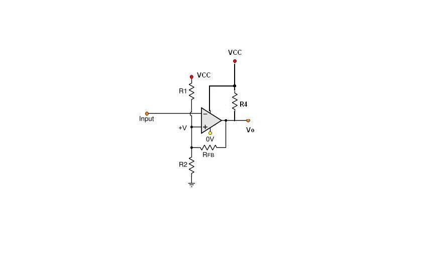

Hi all,
I'm trying to design an inverting schmitt trigger for my circuit (see attached file). I managed to design a non-inverting schmitt trigger but becuase of the feedback loop connecting the input I have a feeling it's screwing up the input signal in the rest of the circuit. I know I can use a buffer to isolate the signal but it's generating other problems.. I know that with the inverting configuration the input is isolated from the feedback so I suspect signal won't be affected.
I'm using a LM393 comparator and according to the data sheet a pull-up resistor is needed (they suggest a value of 3k). When I do node voltage analysis I get the equation in the document attached. But when I get my values for my resistors from these equations, my circuit does not work at all! Am I doing something retarded? Please help!
Thanks!
FYI: The threshold voltages for my design are:
Vlower = 0.1V
Vupper = 0.3V

Hi Eric,
Here is the revised schematic
Cheers
EDIT: Vref is actually meant to be 0.104V - so just approximate it to 0.1V I suppose

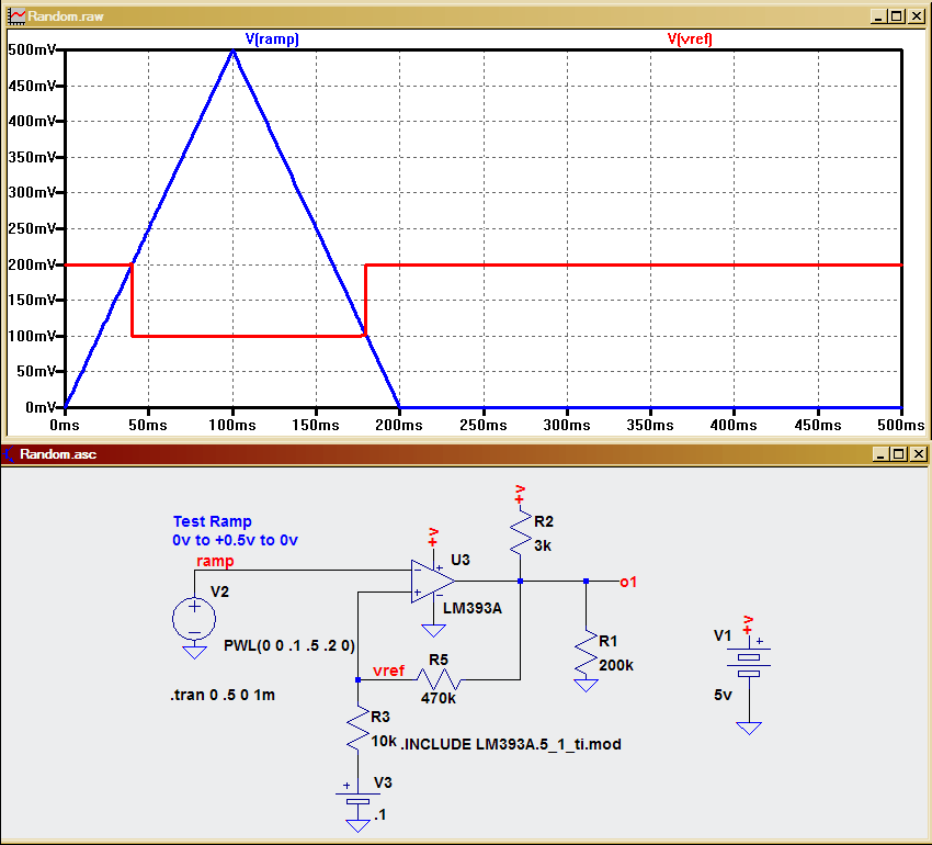

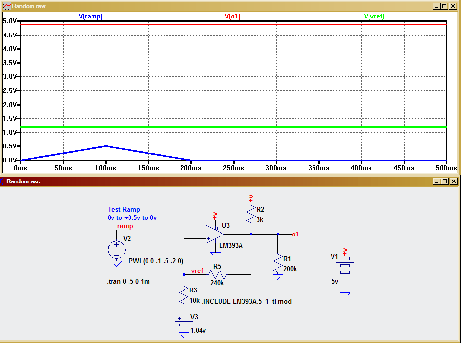

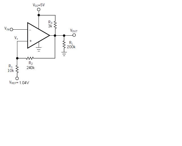

hi Random,
The Vref is too high, the 0 to +0.5v signal never passes the threshold.
Look at the LTspice simulation plot.
EDIT:
this 2nd image is closer, I would use resistors for 0.1V from the +5v line.

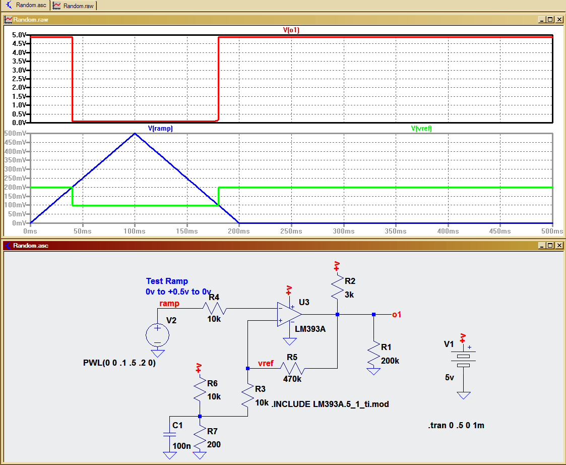

This should do what you are asking.

Hi eric,
Thanks for all of that. I'm just wondering in your last schematic - is there any purpose for R4? Also is C1 used to ensure that any noise in the supply voltage gets shorted through it?
Cheers
Hi eric,
Cheers
I always add a series resistor to OPA/Comp inputs, its gives protection against heavy currents flowing into the inputs.
C1 as you say is a simple noise filter.
If you require an adjustable voltage threshold, change the 200R to a 500R variable, be aware the threshold change will change the hysteresis a little.
Hi Eric,
Thanks for all your help - I tested it out with the rest of my circuit and it works as expected which is great!
