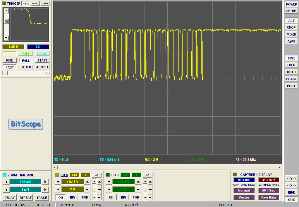

I'm totally fishing here, but I just thought I'd ask anyway.
I have no idea HOW or WHY, but the IR reciever I was using (which is just a microcontroller that interprets the data from the remote and outputs serial) decided to switch from 2400 baud to 1200 baud. Yeah, I used it for weeks and everything was fine and then it stopped working and I brought it inside and it is now outputting at 1200 baud.
Anyway, I want to just replace the whole thing (it's out of a commercial IR reciever, i just took the whole board out and it's way too big for what simple purpose it serves) with an 8-pin PIC.
So, now I have to interpret the data stream coming from the IR reciever element itself. Attached is the data stream for one button press. I need to sit down and try to sort out any patterns in the packet (ie- assuming 8-bit data bytes, figure out what parts are data, and what parts are start and stop bits for each byte, etc...) so I can figure out the data encoding scheme... but anyway, finally to the point, I just thought I'd post this up here in case anyone recognized the data structuring (perhaps it's used in other remote controls?) and could point me in the right direction before I spend lots of time frustrated.
If all else fails, I can just have the PIC read the entire data packet, with the proper bit timing, and pretend the whole thing is one big long string of data. Obviously that isn't very memory-efficient, so i'd rather try to find a "decoder ring" for it instead, so I can get just the useful data from it.
oh, and if it makes any difference, the display is 10mS/div (5mS *2 because it's zoomed out)... the first big low section is 9mS long, and the bit timing seems to be 1.1 or 1.2 mS.

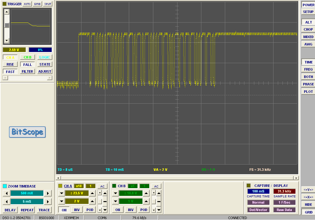

Oh, and thank you nigel for the tip. I looked into it and I am not sure whether it's actually RC5, but now that I looked at some RC5 info I realized that it's very likely that the data uses manchester (or other similar) encoding (since during the actual data stream, there is never more than 2 bits in a row high or low) which immediately cuts the amount of actual bits in the data stream by half.

i see a pattern of 1 5 5 1 2 2 4 1
as the starting sequence..
at least this is the same in both pics..

now it seems to me that the data starts after the second number two..
not the 1 as priviously posted so the data on the first one is
4 1 2 1 1 1 1 3 3 and the second one is
4 1 3 1 1 1 3 1 2
3 2 1 2 1 1 2 3 2
3 3 1 2 1 2 1 3 1
1 5 5 1 2 2 4 1 2 1 1 1 1 3 3

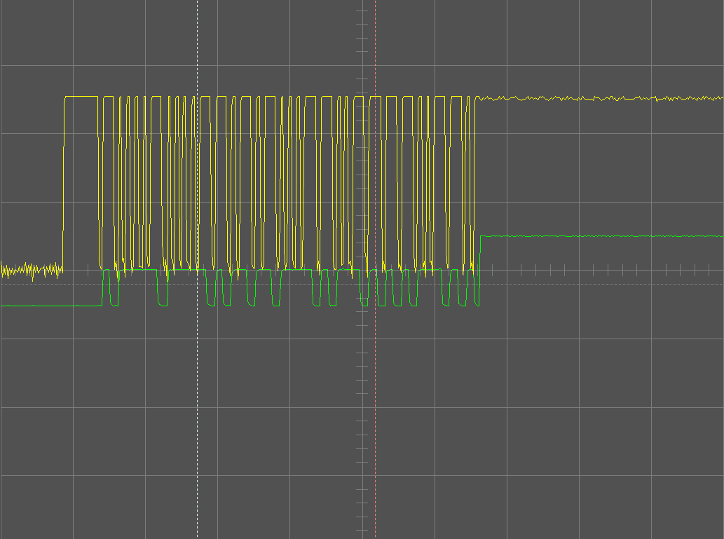

I looked around some more, and it appears they are using RZ (return-to-zero) encoding. Each bit time is about 1.1 mS (the width between two pulse edges in those groups) and a 1 is represented by a pulse for half that period, and a 0 is represented by no pulse...
The nice thing is, the code to read the RZ data is really a subset of the code to count the pulses in each group, so I can do it either way once I get the code written.
FINALLY!
note to self: always disable A/D converters and comparators in a PIC first thing... don't assume microchip was smart enough to leave them disabled by default...
note that the green trace is the "decoded" data stream, and it lags behind by a bit because it doesn't display until after the "bit timer" elapses. but obviously it's working!
also, disregard the green trace after the data... it's set at 10v/div and only a 5v input range, so obviously it's not REALLY jumping up to 10 volts at the end... just a weirdness of the scope...
