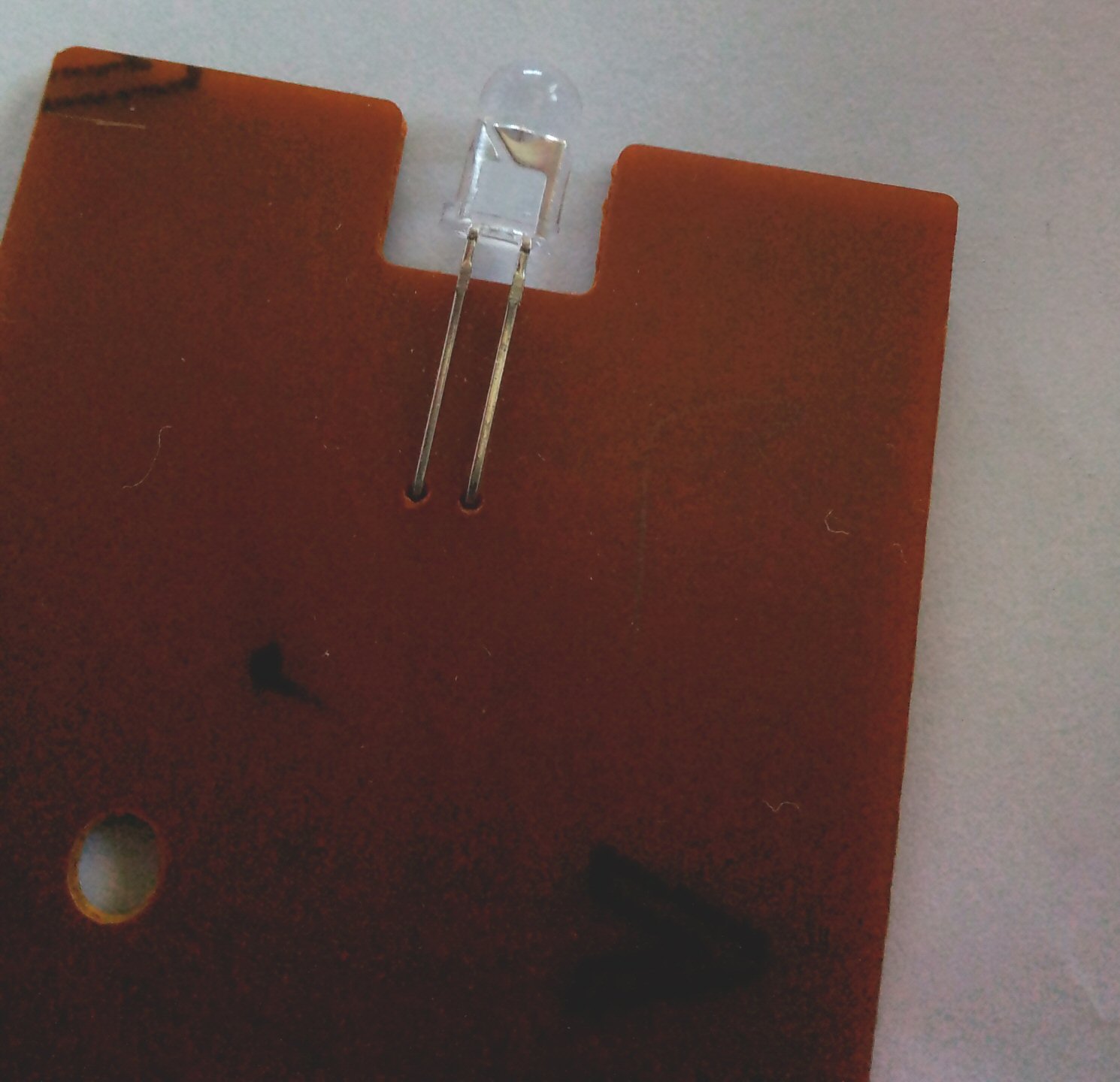

Here is IR diode that I need to replace.

As you have only just disassembled it how could you be so sure it is the IR LED that was faulty in an earlier post and not the driver transistor or another component ?

As Les said, how do you know that's what it needs as you hadn't taken it apart before? - it's only one of the components in the remote control. The LED's do fail occasionally, but it's fairly rare - and mostly they are broken off, having been dropped. Most common problem is probably the ceramic resonator, again the connections break, due to the control been dropped. Whenever I replaced the resonators I always placed a piece of double-sided tape underneath it, to prevent future breakage.

I made just one little scratch, only because I didn't use proper tool immediately. Rest is untouched.
I tested IR diode with multimeter, it doesn't flash, and there is resistance.
It won't flash as it's IR, and like most things you can't test it in circuit - once out of circuit you 'may' be able to test it on the diode test range, if your meter provides enough voltage to do so.
It doesn't sound like it's faulty?.
If it has not already been mentioned a quick test is to point a digital camera at the remote and press one of the buttons. You should see the LED flashing as many digital cameras respond to IR. (Not all do as there could be an infra red filter between the lens and camera chip.)
