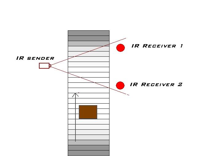

hello
am a mechatronics student, we work a lot on this kind of stuff.
here is a classic sensors arangement that can be used for the purpose you need.
Using a standard 38 Khz sensor (ambiant light ingnoring) you can easily reach your 5m requirement.
the sender is a high power IR led.
connecting all this the computer parrallel port would be very easy, and you don't even need a uController (those kind of sensors are TTL compatible)
good luck

Hey Guys,
The objects are small boxes passed along a gravity conveyor belt(not motorised) at a constant speed.
hi jnthn
looking at your diagram my concern would be the accuracy of the system.
Depending upon the size of the object and its distance from the IR emitter
the 'apparent' speed would vary.
I appreciate that you could have the IR receivers close together, but that
would give you a very short object moved path distance.
I would suggest that you use two IR sources that produce two parallel
IR beams across the objects path.

Hi Eric,
The sketch is not to scale, you have a good point as the angle of the beam to each reciever is different, parallel beams with two transmitters would be more accurate. However due to pressing deadlines I think I will abandon the idea and just use a less accurate speed gun.
Thanks alot for all the help
