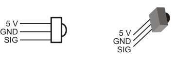

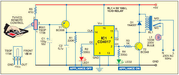

Bit confused about seeing different ir Receiver pin outs as below.

OK, where did you get the little sketch ' IR Receiver Symbols ' .. I think that is incorrect ! The schematic seems right to me

Thanks for your replies, just got them from google.
There is no way to check ,apart from maybe the ground to the shell ! .
Cheers
Spike
OK, two comments then .. .. .. .. my experience is that there are as many incorrect diagrams on Google, as there are correct !
.. .. .. .. .. all the IR receivers I have used have been connected the way the schematic suggests, I guess it's a matter of try one and see !

There are several very distinct types of IR receivers, and there is a part number given in the schematic. Perhaps that's a more effective place to start a search (comparing the piece in hand to a data sheet), than asking people who don't have any clue as to the part he has to to guess?
Using my Google Superpowers, here are two distinct and easily identifiable types of IR receivers. Chances are one of these types match, as least as far as pinout, and if not, spend another 2 minutes searching.

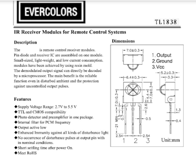

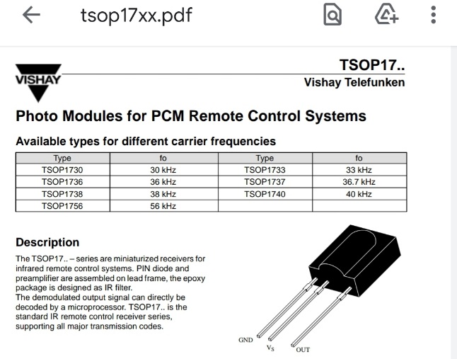

The one I'm currently using has the pinout in the first drawing above. I.E. Left to Right is Out, Gnd, Vcc. And the Vishay datasheet I referred to has two different pinouts. I note that in the datasheet it shows a 33k resistor to Vcc, could this be used to identify the type? The Vishay datasheet does not show the offset pin as in the above datasheet.
The tsop1738 is obsolete. datasheet here: https://drive.google.com/file/d/17quZDUJlujMtpBa-bwOdghsv7O8pEucu/view
R5 in the circuit diagram of 47 ohms might confuse someone. It's basically a fuse. There is an 80K built in pull-up in the receiver.
The pull-up depends on what logic your interfacing too or can interface to. 80K use in the 1738 is a weak pull up. Sometimes power consumption matters. The weak pull up does provide a path for leakage current.
