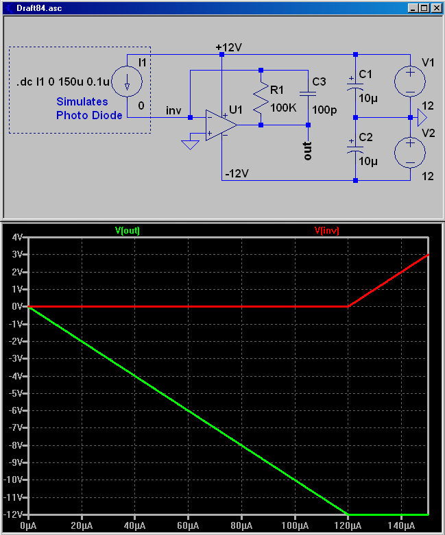

well here is my schematic
my problem is that if i get the transmitter part to transmit at a frequency higher than 256 khz the receiver doesnt seem to work at all . If you have any ideas plz share
