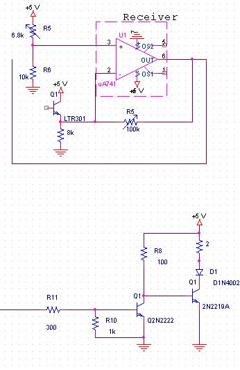

hey guys i have been trying to build a micro mouse for a while...:)
everything is great except the IR sensors cant get the signal of the receiver to amplify any suggestion....
I have included the schematics any help and criticism is welcome
Thanks in advance:)

hey, can u tell me that which sensors r to be connected to micromouse for more fine working and how?
