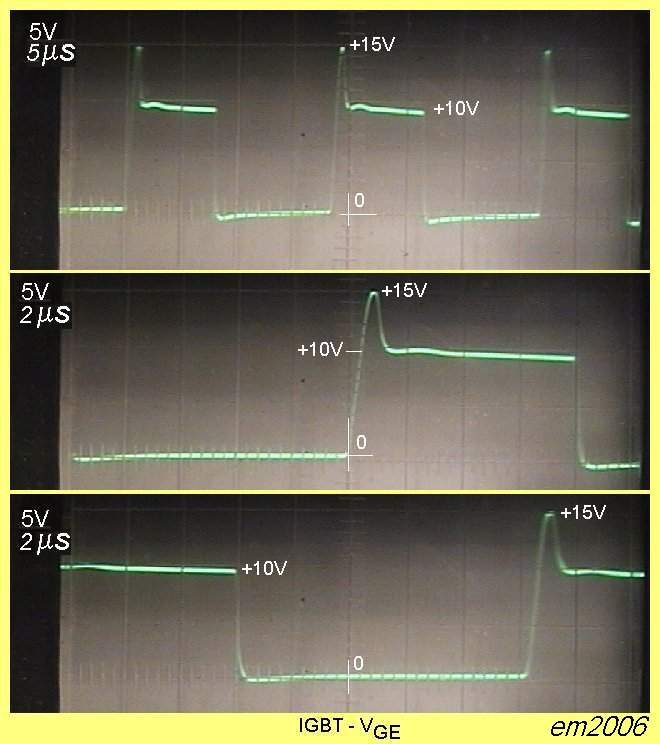

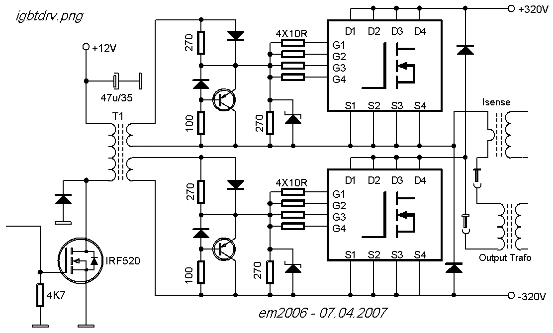

In the attached files you can see a portion of schematic diagram and the Gate-Emitter Voltage (waves) of your IGBTs used in a welding inverter wich I have repaired recently.
I used a 0-10MHz scope.
