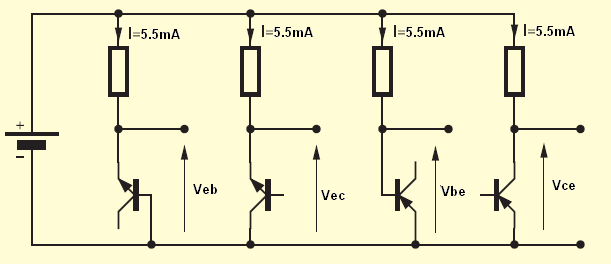

Long time ago I measure reverse-bias breakdown voltage from emitter to base and emitter to collector in general purpose BJT
2-png.61746
For PNP
BC556
Vbe=10V; Uce=10.65V
BD140
Ube=12.55V ; Uce=13.02V
And for NPN
BC337-40
Veb=8.2V; Vec=6.7V; I=5.5mA
BC549B
Veb=8.3V; Vec=7.2V; I=5.5mA
BD139-16
Veb=8.5V; Vec=6.7V; I=5.5mA
BC639
Vbe=7.7V; Vec=6.3V; I=500uA
BC337
Veb=7.9V; Vec=6,4V; I=500uA
2SC945
Veb=8.1V; Vec=7,5V; I=500uA

Transistors have absolute maximum voltage spec's on their datasheets. The reverse-biased emitter-base junction is usually spec'd at 5V or 6V. A higher voltage (as Jony showed) causes the junction to have avalanche breakdown (like a zener diode). The avalanche breakdown causes hot spots on the emitter-base junction and since it is not designed to dissipate heat like the collector is then the transistor is slowly damaged.
It should be obvious that a transistor connected with backwards polarity works very poorly when the voltage is low enough to avoid avalanche breakdown. If its current gain is normally 200 then it is about 5 when connected backwards.
A Mosfet has a "body diode" as part of its structure that conducts when its drain-source voltage is backwards.

The most NPN BJT that I measured has base emitter reverse voltage breakdowns near 8V or higher. And collector emitter breakdown voltage was smaller then Vbe reverse breakdown voltage.
And in NPN when Vce reverse voltage breakdown occurs the junction has a negative resistance region.

It's quite a coincidence that you were able to measure the breakdown voltage of four transistors in different modes of operation and all four started to breakdown at exactly 5.5ma each. I guess it's possible but i would have expected at least some difference.
Could it be that the breakdown voltages are really a little lower than that?
Also, did you check the frequency response and gain of each transistor before and after the breakdown tests?
