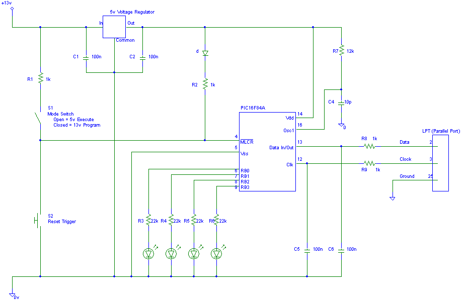

I'm new to the whole microcontroller scene. I just built, according to a kit (**broken link removed**), a very simple PIC programmer and test board. This was designed for and supplied with a PIC30F84A, which I understand to be and old but faithful member of the PIC family and a suitable starting platform.
Anyway, I built the circuit as per the instructions. Then I ran the (very basic) send program which is supposed to take my assembled program (currently using a supplied example program as advised to) and sends it, via the parallel port, to the PIC. Then the PIC, once brought out of program/verify mode, is supposed to light up a couple of LEDs that are directly wired to its B port.
But... it doesn't. The PIC apparently does nothing. All I/O ports remain low during runtime. Since I'm using a very simple programmer, there's no obvious way I can see to tell where the problem lies - whether it is during the programming or the runtime.
As far as I can tell, the hardware is fine. All solder joints are good and continuity tests show now problems anywhere. Power is being supplied at the appropriate pins. While in program/verify mode, the voltage at MLCR is just shy of 12v, when switched to runtime mode, 5v. There is a RC clock input at the oscillator in pin.
My problem is that I really can't see how to diagnose this problem. I personally suspect the problem lies with the PC's LPT port used for the interface; neither the clock nor data pins used change in the slightest when the program is supposedly being transferred (using an oscilloscope to monitor), they both seem to sit at around 5v, although this might be all I'd be able to see.
There is only one problem I can see at the moment (seems unlikely somehow). The programming voltage is not quite in the 12-14v range. It's hovering at 11.9v, which I figure is close enough... is this a bad assumption? I'm planning to get a more powerful supply tomorrow to push it a little further but I'm not optimistic.
The design is that of EPE magasine 1998. I'm using the "PIC16F84 Programmer" by Derren Crome as my software send program, and I run its PIC configuration wizard, but similarly I have no idea if it's working. I've attached my program listing, I'm wondering if there's a simpler program, but I'm not yet understanding this code and don't feel up to changing it just yet...
Any ideas on how to test and work out what's wrong?

Can you scan and post the circuit?.
Hmm, can't scan it but attached shows what I've got built. A very simple programmer, as you can see, with 4 LED outputs in the B port I'm using for testing.

F*SH said:
You're right about 'send.exe'. All it can do is load the program and configuration word. No reading or verfiying, but I assumed that was a limitation of the software, not the of the hardware, as I figured the data/clock lines worked in both directions.
The pins on a standard parallel port are either an input, or an output, but can't be both - so with the data pin of the PIC connected to an output you can only write the chip, and not read or verify it.
Modern parallel ports do have various bi-directional facilities, but I've not seen a PIC programmer that uses them - no point, as proper hardware design prevents it being required.

The 'easy' solution to this as I see it would be to simply connect the data line to a second, opposite direction, parallel pin. Would this work or would I need to start using diodes and the like to prevent conflicts?
You need to isolate the connections, it's usual to use an open-collector buffer between the output of the port and the input of the PIC, along with a pull-up resistor. When this buffer is turned OFF the data line is free to work the other way.

F*SH said:
Ah yes of course. Shouldn't be hard to modify my circuit to do this as soon as I can get my hands on a pair of buffers. However, that's going to be several days, and I imagine I can get started with the programming without being able to read the controller.
All you need for a buffer is an NPN transistor and two resistors, one as a collector pull-up, the other as a current limiter feeding the base.
Picprogrammers usually switch both Vdd and Vpp by software, that programmer does neither, which could well be a problem. The software usually verifies as it goes as well, and this will obviously fail as there's no reading possible.
