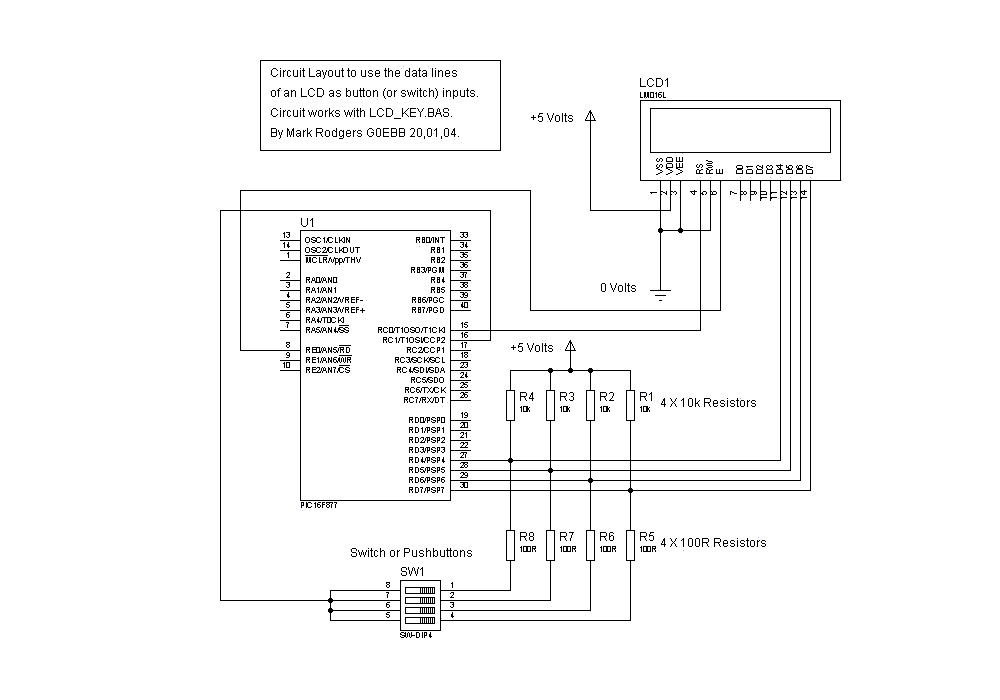

Is it possable to a 4x3 keypad in this circuit
1Steveo
I'm running out of IO pins (16f675 14pin) and realy like to keep the lcd with out getting a serial one!
Thanks for looking
Steve

Can you tell us what you need to hook up to the 14 pin PIC please?
2 pins - VDD and VSS
6 pins - LCD
1 pin - MCLR Reset?
What else?
Regards, Mike

With reference to your diagram above,
Replace the 100R resistors with 1N4148 diodes pointing down.
Replace the switches with your 4*3 keypad.
The 4 row connectors go to the diodes.
The 3 column connectors go to 3 I/O pins.
In your initialisation software,
Initialise the 3 pins connected to the keypad to outputs and set them high.
To read the keypad,
Set the 4 data lines to input.
Set one of the 3 pins low.
Read the 4 data lines.
The value read is the column connected to the pin you set low. A zero = key pressed.
Set the pin high again.
Repeat for the other columns.
Set the data lines back to output.
By my counting, thats a total of 9 I/O pins needed.
HTH
Edit, can't count.

I assumed he wanted to use this type of keypad.
Available everywhere.
With a number of carefully selected resistors, you can make a unique voltage divider for each button on the keypad. You can then sample the voltage created using a single analog input pin and the A/D converter.
Here is an example with 8 discrete switches. You will have to adjust it to work with a matrix style keypad.
yes that is what i meant from my post above :) i think i may try this as it certainly does cut down on pins :p thank you.
