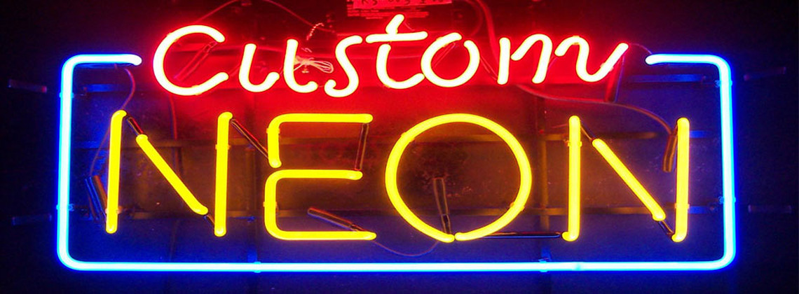

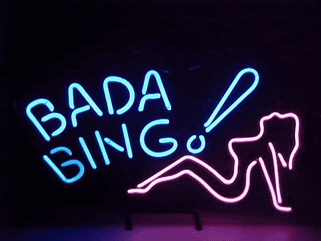

View attachment 106134 View attachment 106133 An LED stripleds design must be diffused which reduces the efficacy and still does not have the spectral purity of Neon, which is just a custom inert gas in a vacuumed tube with excitation voltage like modern T8 tube invertors, not old fashioned oil filled transformers,
good LED luminaire design is possible, but rare.
get neon
but worry amount China's toxic water and spread to environment from high tech toxic processes and contaminants getting into other goods. Toxic waste is real, even if you don't think the conversion of a trillion barrels of oil into pollution has no effect on climate.
