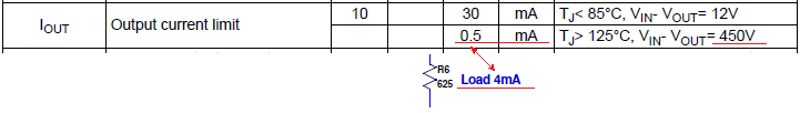

Another point is that the 2V5 bias rail is supplied by an LR8N8 high voltage linear regulator. The designer put no input capacitance at this regulator’s input. I can’t see this being a problem, but I recognise that it is often classed as ‘standard procedure’ to put a capacitor at the input to a linear regulator (but the LR8N8 datasheet doesn’t even mention an input capacitor.)

A representative schematic of the Bias section is shown here…also a representative LTspice simulation of it.

why your simulation shows 339V pk-pk next to label 240V mains (what spice does not simulate - is some sort of rect. bridge effect of rising the input voltage name value to 1.2x up to 1.7x at output capacitor ... in your case 1.41... x ) . . . also i suggest stating your signal(or reference) ground in between L & N by 2 symmetrical , in series capacitor 1n resistor 10meg pairs and re-naming your rectified signal ground (such becomes more relevant when inductors / filters follow the rectifier)
Thanks, ......though our vout is 4mA and only 2V5...I presume you mean our LR8N8 regulator.
