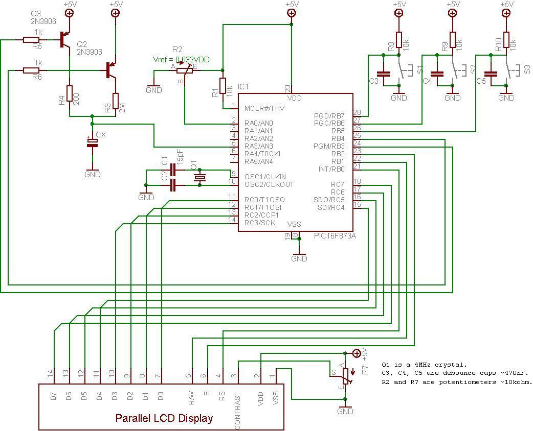

Hi folks,
Just trying to figure out if I could use a PIC 16F872 instead of the 16F873 that is used in the Cap meter shown in the link?
If anyone has any info if its possible or even if I could use the 16F874, please let me know.
I have both 872 and 874 PICs on hand but no 873s and I was hoping to use the original code that the author shows, would there be a difference?
Thanks................Al :confused:
It may work. The 872 has only half the memory and much less ram than the 873. It also lacks comparators and only has 1 ccp module. You link isn't showing so I can't look at the code.

Unfortunately, it's exceeded it's download limit so is unavailable.
BTW, the 874 will definitely work but obviously won't fit a PCB due to it being 40 pin.

Schematic and ASM from Pic cap meter

Unfortunately, it uses a comparator and so the 872 won't work. Infact, the 873 won't work either. It has to be a 873A as the earlier version doesn't have the comparators. The 874A will work.
874 maybe not 874A?
Hi Mike,
Just one last question then, would the 16F874 work or does it need to be the "A"? The 874 datasheet shows a comparator I think, well it shows two Capture Compare modules.
