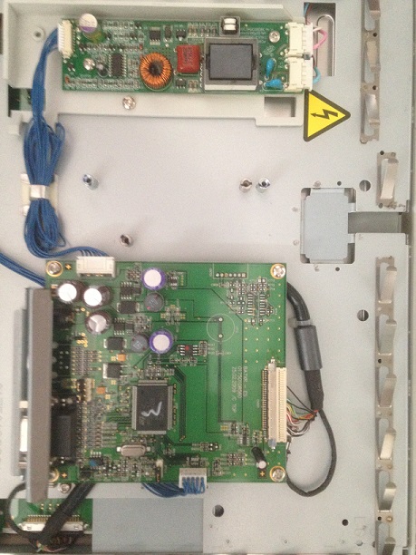

I removed one today and into the workshop, fired it up with 12vdc @ 3amps the label says it needs.
It leapt into life immediately, showing the Nixdorf emblem and then a box stating 'No Signal' but then after a few seconds screen dies and that's it, nothing more.
As far as I can ascertain, it's drawing about 500mA when the emblem appears which drops to 200mA when the No Signal appears; When all goes off, it drops to about 20mA, not zero which is what I expected.
I'm not planning on messing with this too much because I know so little about them, but I did just wonder if this monitors' behaviour is familiar to those of you 'in the know' ?
I've attached a picture for the curious .. .. .

It looks like the monitor is going into standby because of no video.
My computer monitor does the same thing, although it's powered by AC.
I suspect that the white box at the top of the picture is the inverter for the backlight.
monitors will often go into standby mode when you turn them on with no signal. my immediate guess is that the power bricks for the monitors are bad. 20mA in standby mode is normal. if you repeat your test with a computer connected and operating, and the screen stays on, replace the power bricks for the monitors. if it still blacks out soon after being turned on with a video source connected, you are losing your backlight supply, and if you shine a strong flashlight at the screen and see outlines of things on the screen, it's only the backlight that's shutting down. the backlight supply is the board at the top of the picture, and it looks like you have fluorescent tube backlighting (the wires going to the backlight have high voltage insulation). occasionally the backlight wires can get hung up on sharp corners in the aluminum near where they come out of the panel, and arcing to a metal corner can cause the backlight supply to shut down.

I did wonder if the lack of a connected signal was the problem and connected a working PC but alas .. .. .. . ..
However, the flashlight trick seems to confirm a backlight problem .. …
