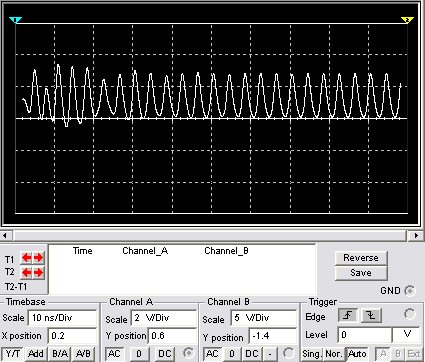

I'm studying electronics communications and I have a big ass. on the class E amplifier and applications. I also have to come up with some new application for this amplifier. (Ironic I'm not too good in electronics and I choose this course but I like it is quite interesting and I'm hoping that I'll get better understanding)
I know it not an oscillator but it does give out an oscillation, no?....maybe not a perfect sine wave but very close.

So if I want an input square wave signal with a 200 KHz, what would be the max freq that I can get at the output? And which components in the circuit would affect the output frequency?
components spec:
Vdc : 6V
Q = 5
Inductor choke: 7nH
Shunt capacitor : 2.9237pF
Series capacitor : 4.136pF
Series inductor : 300nH
Rload : 100ohms
Note: Once the amplitude becomes constant it stays that way.
In the picture below the input freq is 250MHz and output is also 250MHz.

No, because it's not, it's simply amplifying a pulse, and resonating a tuned circuit.
Can this amplifier be used as an oscillator in a transmitter?
No, because it doesn't oscillate.

Both the capacitors, and both the inductors, will affect the resonant frequency - the two in series look to be a series resonant circuit, and the other two a parallel resonant circuit.
Nigel Goodwin wrote: “It's commonly used as a frequency multiplier”
The freq is not multiplying?
It depends on how you use it, the output frequency will be that specified by it's resonant frequency (assuming the input frequency is capable of exciting the circuit). If your output is tuned to 100MHz, input a frequency of 50MHz will double it to 100MHz (2nd harmonic), likewise 33MHz input will triple to 100MHz (3rd harmonic). If you input 100MHz it won't multiply, just amplify.
