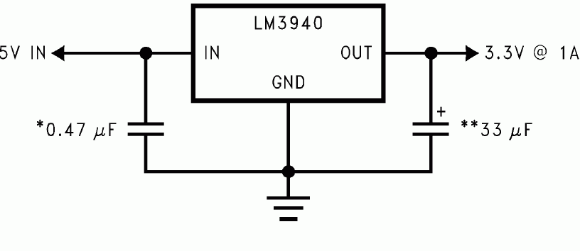

Is there a 3.3V replacement for the LM7805?
What current do you need? and what is the input voltage?
The LM3940 can't be operated with high input voltages.
The LM2937-3.3 has a wide input voltage range but it can supply up to 500 mA.
An LM317 can supply 3.3v - it's not a direct replacement, you have to use two resistors to set the voltage.
It is a good regulator though -better than a 7805.
