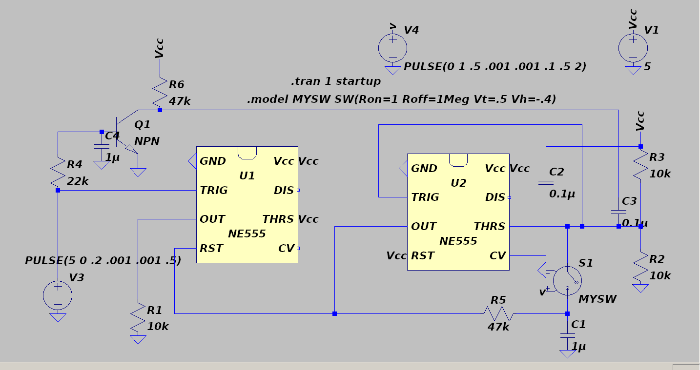

I came up with this little 2x 555 (or 1x 556) circuit to set an output high when an event happens, and then to be able to set it low again with a pushbutton even if the input event is still happening.
The input event is V3, the pushbutton is MYSW, driven by V4.
U1 is a simple bi-stable, and U2 is a momentary-switch-to-toggle-switch-converter. C2 ensures it always starts with a high output, C1 stores whatever state the output happens to be, Q1 and friends toggle the circuit back to the on state when the event is finished. Simulation works well.
It seems a bit complicated for what it does, I wondered if there is something simpler?

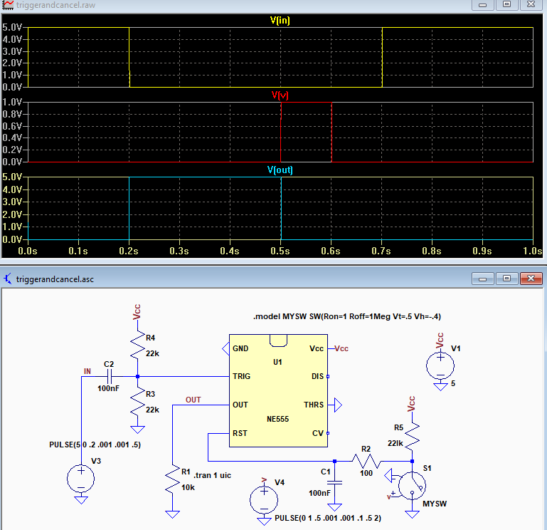

It's output goes high when the trigger input goes low, then goes low again when reset goes low. Oh, I tinkered with the values in-between running and uploading it. Change R5 (back) to 10k, then it works properly. Revision attached.

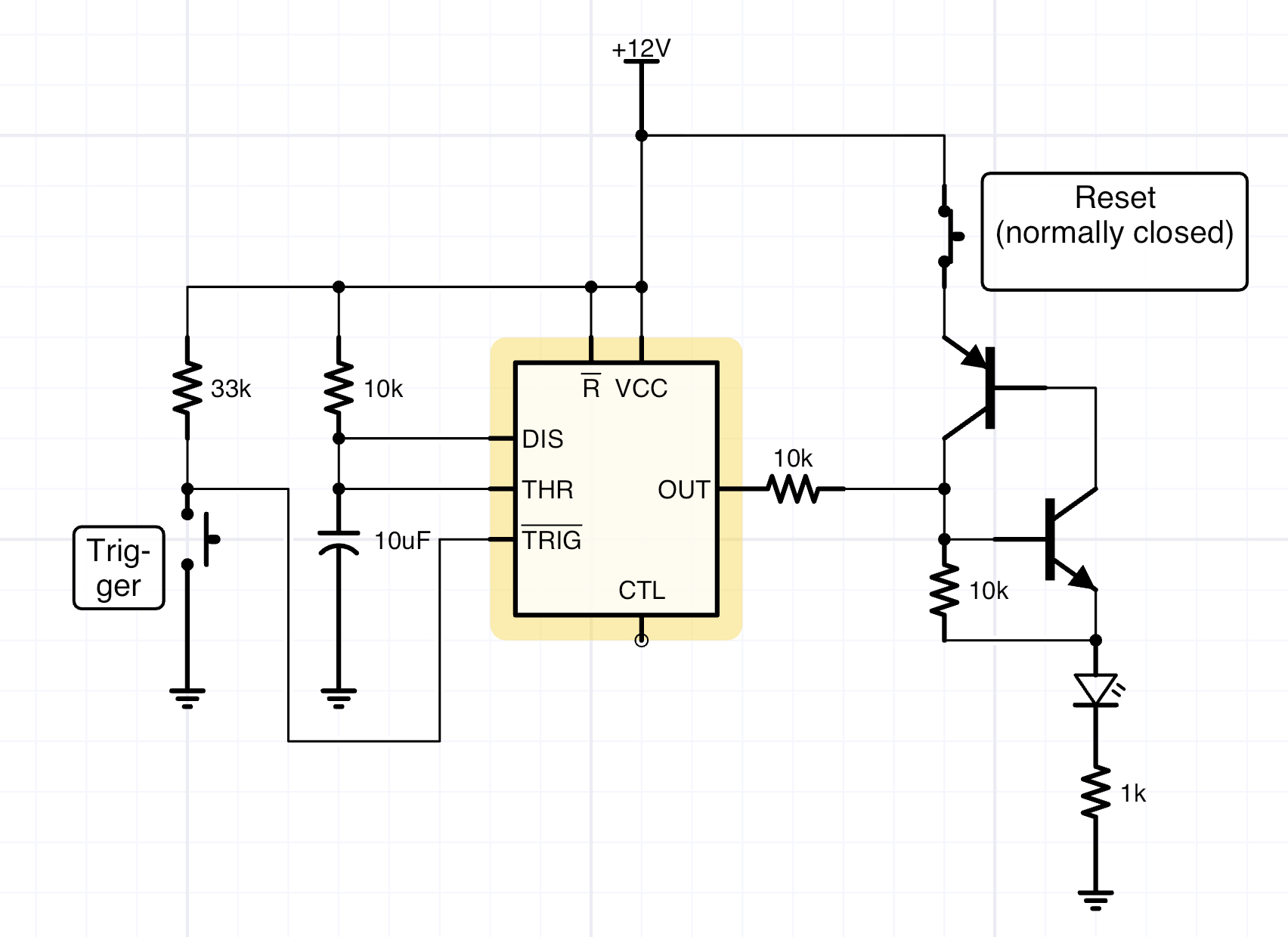

From what I understand, you want an event to trigger the 555, then keep and hold a record that the event happened until a reset button is pressed.
Here, the 555 triggers and goes high for a short time but it triggers a two-transistor SCR that latches and holds with current flowing until a reset button is pressed.

About as simple as I can get it using a 555. ;-)

"Should work with N/O if it's across the lower 10k resistor" ... Not necessarily, with an SCR shutoff can be tricky without completely removing power.

I was going to post update. A NO switch in parallel with the lower 10k will do the trick to reset. Thanks Beau Schwabe !!!
Hmmm, it seems LTSpice is very fickle when it comes to the behaviour of the Threshold pin of it's 555 model depending on the simulation type. Hence AG's initial comment that U1 doesn't do anything. When I ran your version crutschow, it didn't work, then I noticed the uic setting. Threshold works opposite way when uic is not set. So it works now. Will try gophert's later.

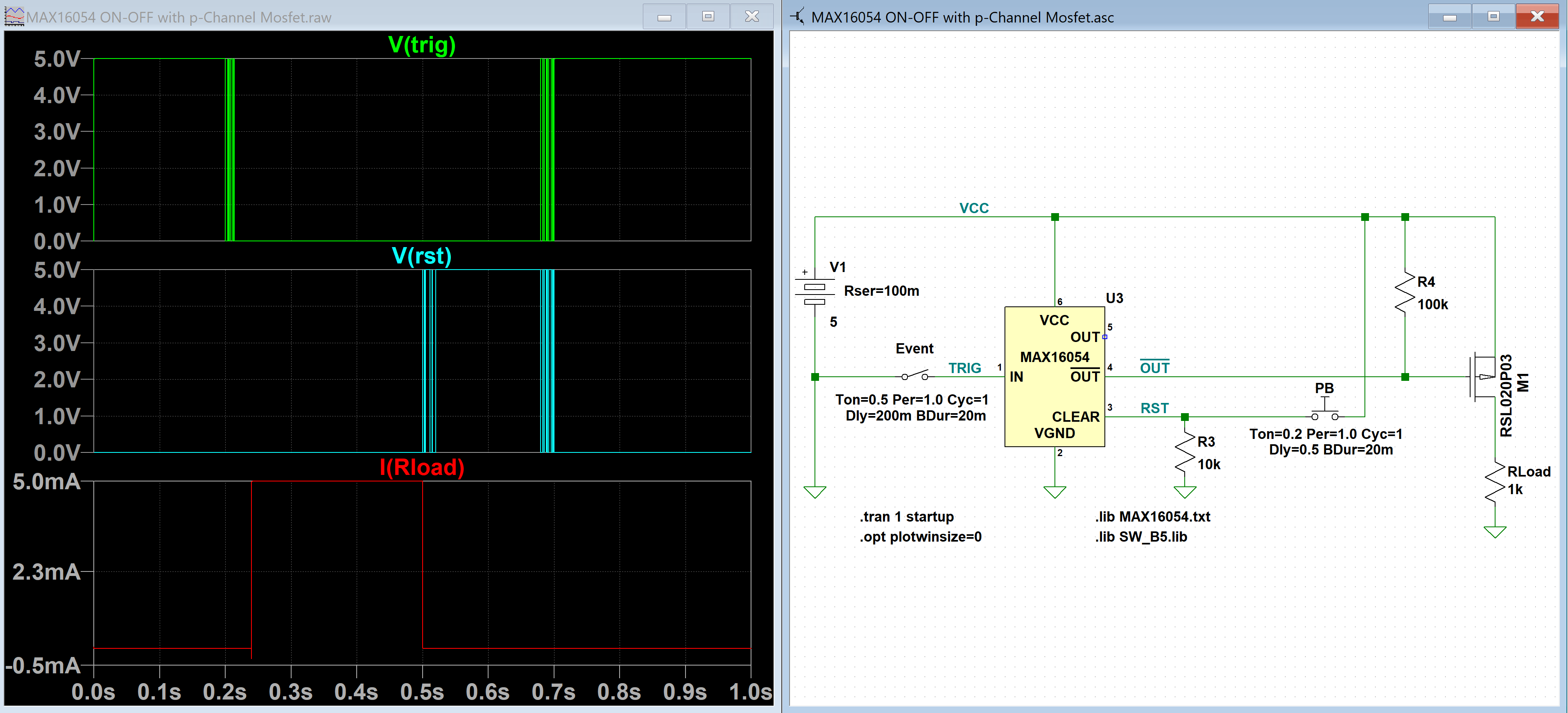

It seems you want to set a latch that can be manually reset, and drive a load beyond what a 555 can handle(?)
So is a timer really needed? if not, here's an option.
In theory, you can eliminate the 555 altogether in my two-transistor SRC.
Hi eTech, nice idea but the MAX16054 is quite an expensive option! A timer is absolutely not needed, but the 555 is a good option to try for this kind of thing because it is very cheap and extremely versatile and doesn't actually have to be used for timing purposes. Thanks for the suggestion though.
Gophert, I thought the same thing! I should be able to try it in real life before Tuesday :)
compared to 555 yes...but you get simplicity, flexibility, and for this you only need one.:)
Here is a two transistor SCR version that is a little bit easier to turn OFF. Q2 would be your drive transistor and should be rated for whatever load you are using. Q1 is low current and can be just about any PNP transistor. D1 and R5 are essentially your load.
