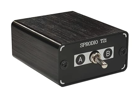

Is there such a thing as a 2 way switch for a 1/8" phone jack?

Is there such a thing as a 2 way switch for 1/8" phone jack, What is the NAME of it?

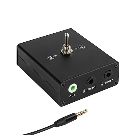

Do you want something like this but with a switch in it? (1/8" =3.5mm)
More like this. "
3.5 mm Audio Switcher, 2 Ports Audio Splitter Box" I can find a number of these.​
Found another one.
If you want to build one, the parts are available.

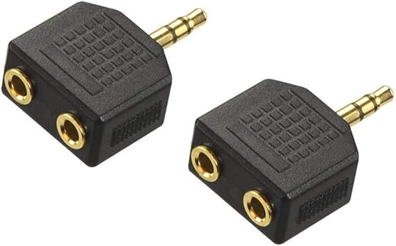

I already have that, can't plug all 3 in at the same time.

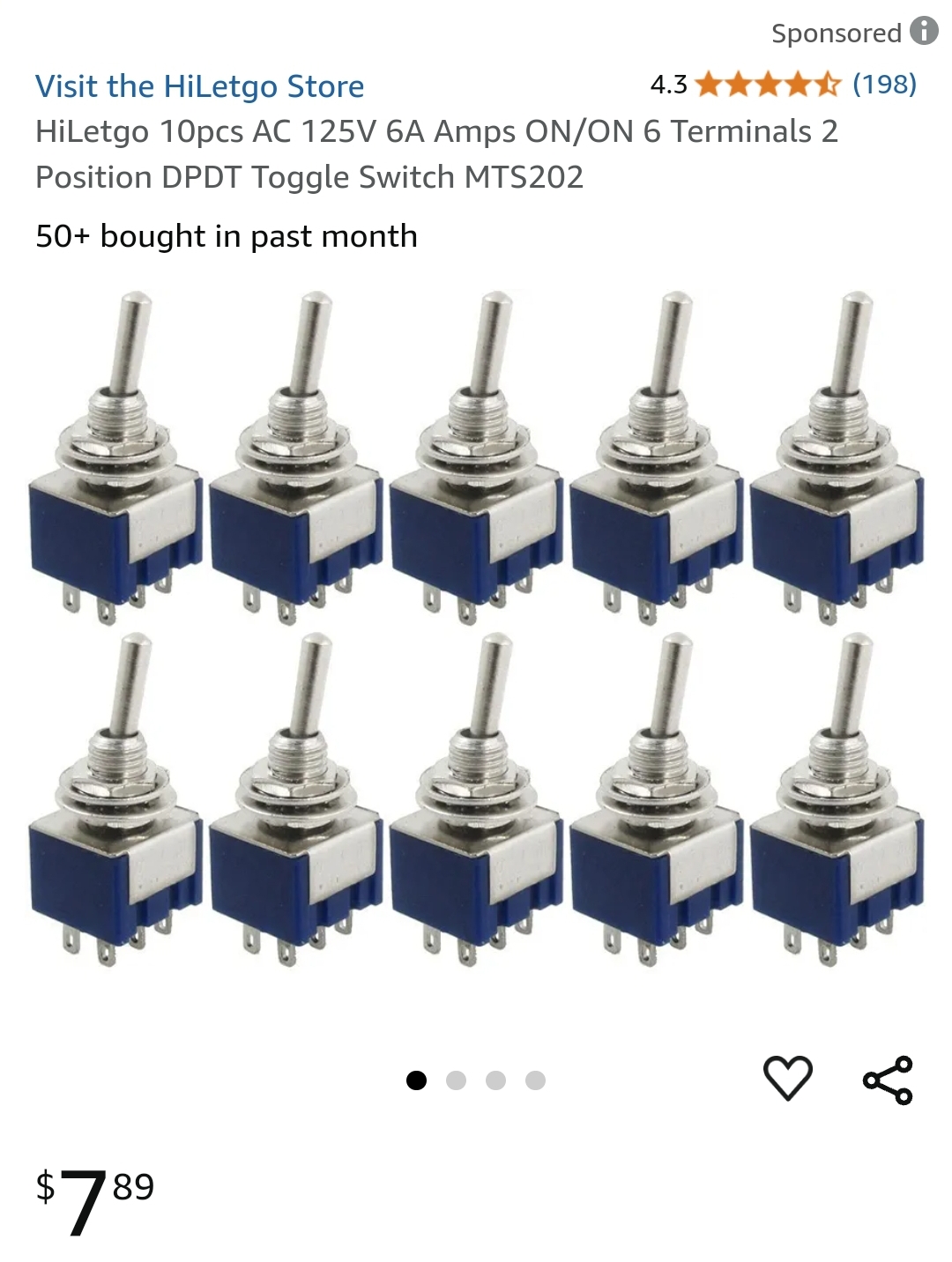

I could build double pole double throw switch if I can buy parts???
Here one from Amazon with volume control on each port.

Audio Switch Box.
This is BACKWARDS there are 2 inputs and 1 output.
How does the switch know?
It works the same way. Zoom into the picture - the side with two jacks say input/output and the side with one jack says, output/input.

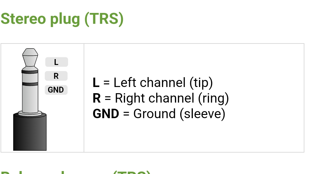

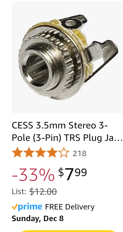

What I would do is get three stereo 3.5mm (⅛") jacks similar to the picture below and a DPDT toggle switch and mount them in some kind of enclosure.
Connect the two non-ground contacts of the input connectors to each side of the DPDT switch and the common pins of the switch to the output connector. Connect the ground connections of all three jacks together.

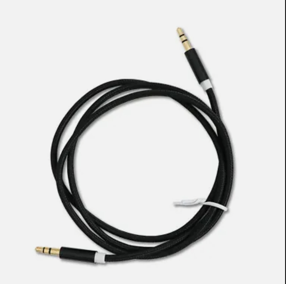

If you need a male connector, buy short stereo 3.5mm male-male cables (which the Dollar Store likely has) to make those connections.
Lest the peanut gallery have any comments about using stereo jacks for these connections, the pictures below illustrated that stereo jacks will work for stereo headphones or stereo earbads/headphones having a microphone.

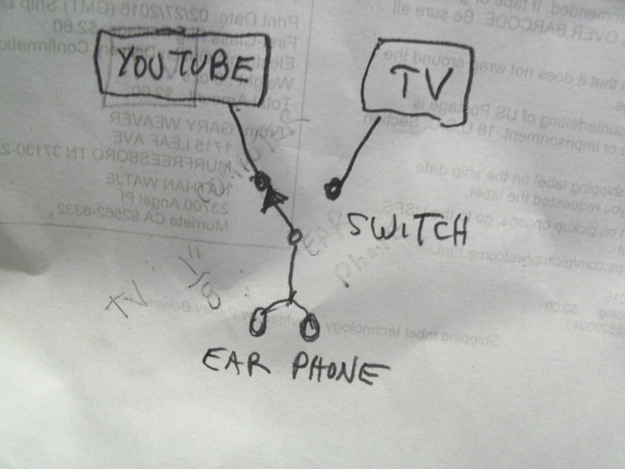

3 female jacks will not work? How do you plug a female jack into another female jack??????? What I need is 2 jacks and 1 female jack.
Picture shows what I have. C plugs into A to listen to YouTube. C plugs into B to listen to TV.
Just to clarify, two male – male cables like this can solve the problem.
