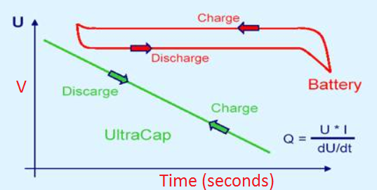

Keeping MikeMI's post in mind, note the graph below:
The voltage, across ALL types of caps (an "Ultra" type in this case) when under a load, drops very quickly, vastly reducing the power (I times E) that can be delivered.
They simply aren't suitable for your application at a reasonable price.

I think the major downside of using caps (of whatever flavor) as a "battery", in particular as you envision, is that their full voltage level immediately starts to drop from its peak as soon as a load is applied. This has the effect of, in a like manner, of quickly reducing the power transferred to the load, as graphically represented in the graph in post #3.
This effect can be lessened, to a degree, by massively over building the circuit by increasing the total capacitance to, in my opinion, ridiculous and very expensive high values for automotive use.
