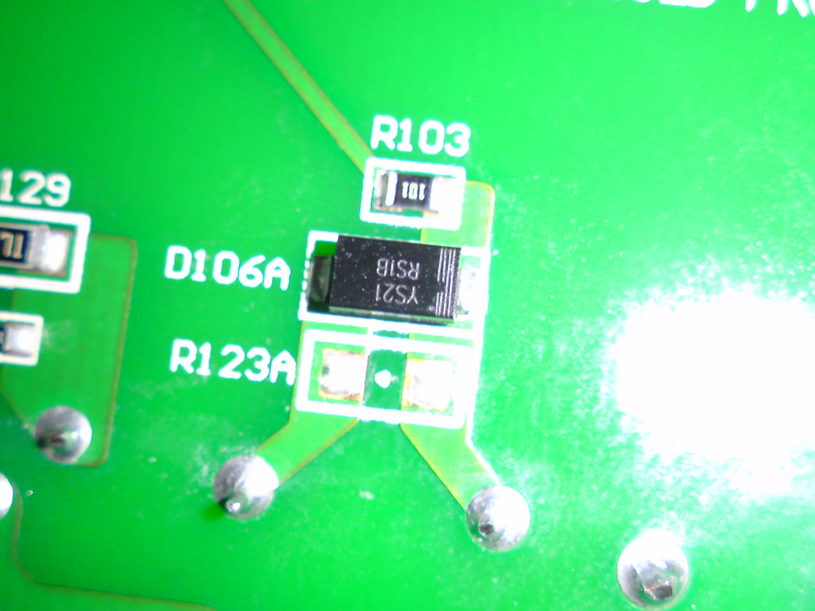

Is this a diode?
1-3-2-4
I did a diode test and it's reading 0V in both directions.. on the other side of it is a white 0.025 Ceramic resistor.
Called D106, looks like a diode so most likely yes. And RS1B matches some silicon 1A 100V diode.
