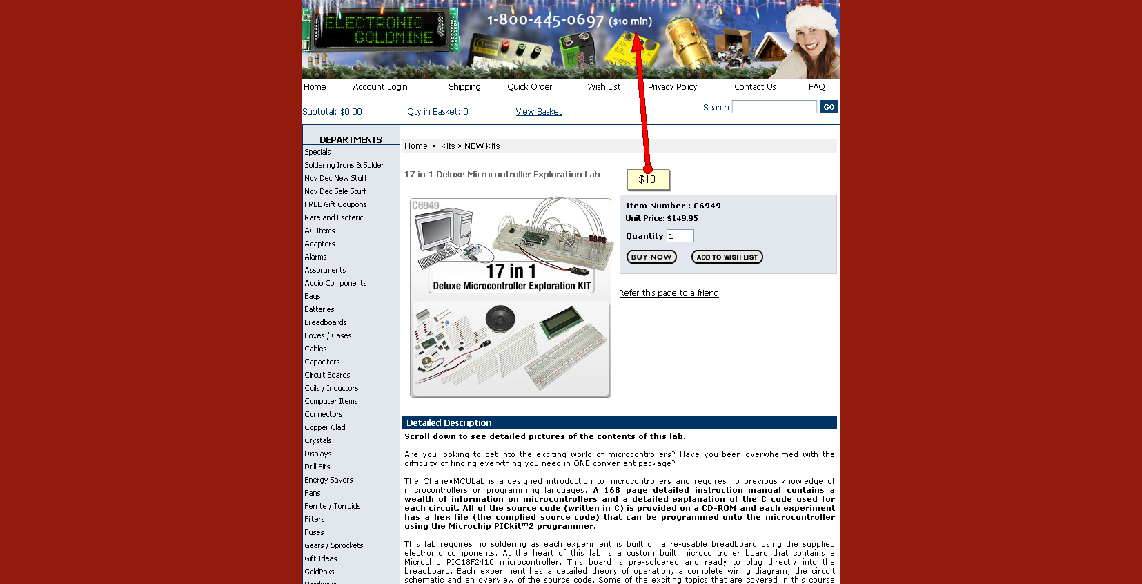

is this a good start for learning pic s?

10$ a min for what phone number where?
from the link the op posted, seems a bit steep but then again i can be tight with cash :D

Wow $10 a minute? That's a good way to discourage annoying phone calls for help.
Maybe we should charge $10 a min to anyone who wants help with their "final year project"? :D
The ($10 Min) refers to their minimum order of $10. But they could do a better job of stating it there as they do on their How to Order page, or not put it there at all.
