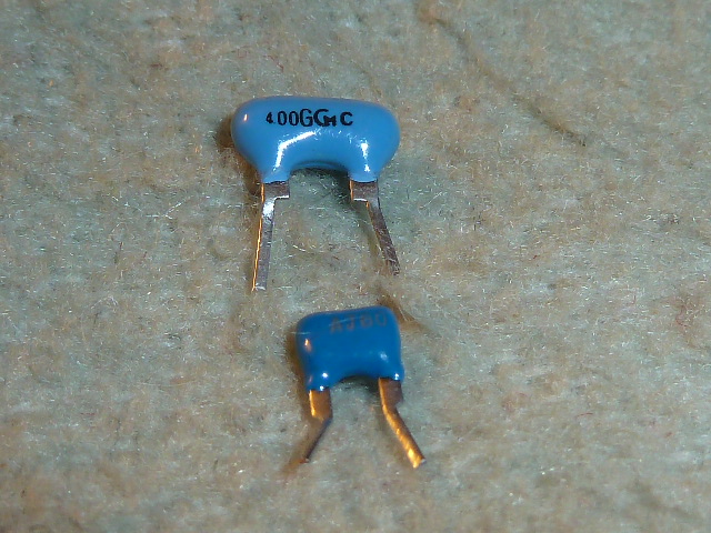

Attached are 2 images. The first shows a 4 MHz ceramic resonator and a 47 pF capacitor. The resonator is the larger item.

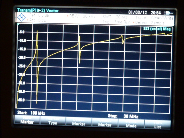

The second image shows a sweep to 30 MHz of the transmission of the resonator between port 1 and port 2 of a network analyzer. Several resonances can be seen. The fundamental resonance appears at 4 MHz, which corresponds to the marking on the unit. The capacitor showed no similar multiple resonances.
Measuring it with an LCR meter isn't going to do much good unless the meter can measure at a frequency equal to one of the resonances. The unit in the picture measures as a 38 pF capacitor on my meter at 1 kHz.
However, you might be able to use another technique to determine if it's a resonator.
I was able to detect the resonances by simply connecting the resonator to the output of a signal generator, setting the output level to .1 volts to avoid damaging the resonator, and monitoring the level across the resonator with a scope. It has fairly high Q, so you have to tune the generator slowly to see the resonator pull down the generator output at series resonance.

They are resonators (as myself and others have said). I have hundreds of them pulled from old equipment as they are one of the parts you can salvage very easily and are quite useful. They come in 2pin and 3pin styles.

The real big square epoxy ones are usually ceramic filters and typically found in RF circuits. The short rounded epoxy ones with 2 or 3 pins are usually resonators and are very common in anything with a microcontroller, and found within an inch or so of the microcontroller IC. There is another type of square resonator in a hard plastic square box pack, these are common in TV remote controls etc and usually a lower freq like 455kHz.

Yes resonators come in two OR three pin packages. The three pin packages include the load capacitors internally and so have a third ground lead.
