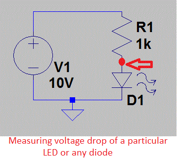

Is this a way to measure forward voltage or V-drop of a particular LED or diodes?
Willen
I use 'diode test/continuity test' feature to measure small red LED's forward voltage (maybe it's its input voltage rating) which is around 1.2V. But when I try to measure Yellow LED, Green, Blue or White LEDs then DMM won't response and shows just 1 or 0 ('N/A' maybe). So I need to measure its forward voltage manually. Is this a way to measure LED's or Diodes's forward voltage, posted schematic here?
I think I just get approx value from the method and won't be accurate as its manufacturer mentioned. Also probably I will get very wrong value if I tried to measure Power LEDs in the circuit. For now I just want to measure small LEDs I have around me (used as indicator LEDs).
(Accuracy is not very critical to me here.)

Hello Willen,
First, very happy to see that you are still doing your electronics stuff in spite of the natural problems in your area of the world.
Second, for testing LEDs, the best way is to drive it at the current you expect to use it at. So even if it is a 20ma LED if you intend to use it at 10ma then test it at 10ma instead.
You can use a resistor and pot to set the current, then measure the voltage.
This is pretty much the best way.
If you want to get a little more into it, you can create a constant current source of maybe 10ma or 20ma and that will force the LED current so you can just measure the voltage.
I usually measure my LEDs at several current levels, like 1ma, 5ma, 10ma, 15ma, and 20ma, noting the forward voltage for each current level. That way when i go to use one, i know what it can and can not do.

Diodes are not linear in their I-V behaviour like resistors - the voltage drop does vary ( in mV) depending on the current. Whether this variation need be taken into account in the design of circuits would depend on the application.
The manufacturer's ratings of the LED voltages are at a specified current - normally the max permitted. The power dissipation is also a factor to be considered when designing driver circuits.
Zener diodes fall under a different category - they are Reverse Biased diodes and operate in the Zener breakdown range. The voltage variations w.r.t current is much smaller and they are used as voltage references unlike LED's.

I suspect that measuring forward voltage with that function, your DMM becomes out of range. Isn't it by chance maximum 2V? I would do simple succesive checks with one, two, three and four Si diodes in series.
Have to check that today on mine.
Post the outcome, please.
If the meter has a 9v battery it'l give you a ball park idea, however it wont be a accurate value unless the led has its intended current through it, which on you meter it probably wont have.
I confirm my post above. Checked right now and above 2 V, my DMM goes out of range.
In diode check function.

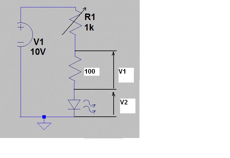

Developing on what others have said, try this:
Adjust the variable resistor R1, and at various settings measure V1 and V2.
Divide the V1 measurements by 100 to get the current in mA.
Then you can plot a graph of V2 on the Y axis against Current on the X axis.
You should be able to see that the voltage remains fairly constant as the current is varied, but the voltage will never be completely constant as the current through the diode varies.

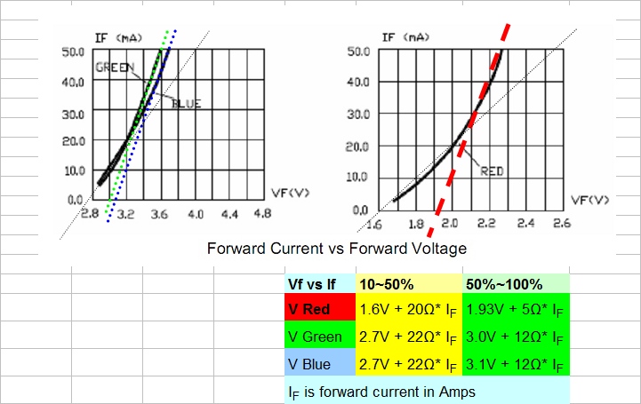

Better DMM's use ~1mA CC with >2V range for diode test so white LEDs (blue substrate) will measure 2.85V at low current .i.e. 10% If.
Since this approx 5% of 20mA rated If, it will read the Vth or threshold voltage which is always proportional to frequency if light. Since IR is the longest Wavelength or lowest frequency, then 660nmD Red then 630nmD Red , then Yellow then Green , Blue, UV etc , Vf= Vth + If*ESR when using approx 10% of If for Vth rather than 5% .
Also rated Power of LED is inverse with ESR so W*ESR ~1 at 25C using rated If not Imax as ESR drops slightly with rising current and rising temp lowers Vth. (NTC effect) Some variations due to quality vs heat capacity of chip exist.
Vth is universal for dominant wavelength Vth but apparent Vth' at 10% If is accurate enough for measuring ESR and using Ohms Law between Vth' and Vf, when Tjcn is considered
Easy test is 9V bat to LED with 2mA or (9-2)/2mA ~ 3.3k Ohms in series . You can also compute current source value of diode test from R test and V across series R.

"All LEDs are diodes"
Which sounds silly but all diodes have a saturation curve that is falls within a 50% tolerance range for effective series resistance, I conveniently call ESR.
The rising decades of current leading up to saturation where the ESR falls sharply from 1000x the saturated ESR.
This is one way to characterize small LEDs with 20mA ratings when used less or pulsed more than ratings.
Keep in mind efficacy always drops with rising power levels, then faster above rated levels.
Note the rated power of any diode also drops the rated current ESR so this product tends to be constant and drops with large rises in junction temperature.
This ESR would included in your external R when using say a 5V supply and two Reds or a 12V supply and 3 or 4 whites.
