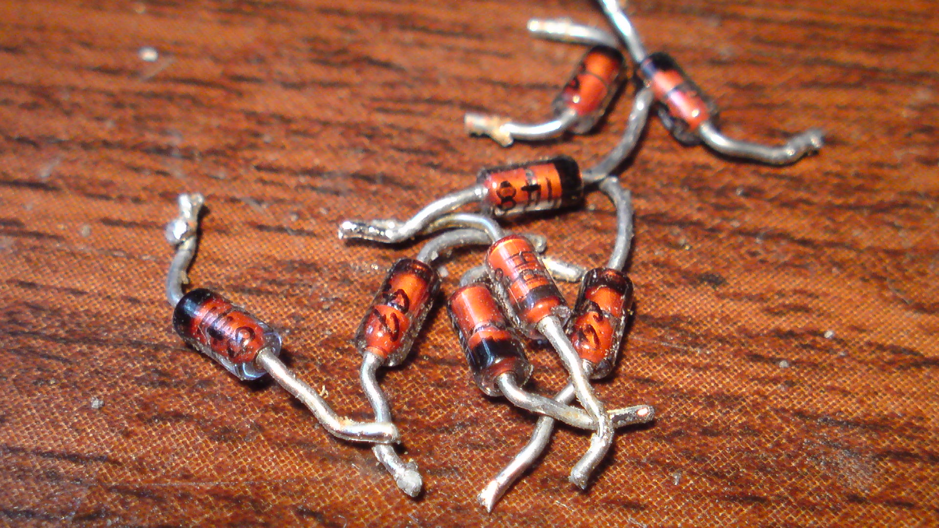

Is this a zener diode?
1-3-2-4
seems like my mouser order of 5 3v zeners walked off so in a effort to find some for a project I took these out of two unused power supplies.
How do I find out what voltage it is?

just use a dmm , one 3.3K resistor and a 12V supply to check out. Connect the 12V + supply to resistor. other side of resistor can be connected to the cathode of diode (marked side) the second side of diode can return to -ve of supply.
use DMM as DC voltmeter and measure across the diode
if it is zenor of less than 12V type, the value would be read
if it is ordinary diode, it would not conduct at 12V, and the meter reads full supply voltage.
this solves you problem rather than imagination.
I don't have any 3.3K resistors on hand can I use 2.2?
they appear to be 1N4148 diodes
yes, some appear to be 4148

Also agree on the likely 1N4148's in the pic.
If you have any other equipment you can cannibalise, look for diodes marked with a digit-V-digit... e.g. 5V3.
HTH.
I just took some out of a Canon battery charger for a XL2 camcorder anyways the PCB labeled them as ZD1, 2 , 3 and so on.
Now that I look at them I don't see any "V" markings but just numbers?
Do you see any BZX or BZY markings?
You may need a jeweller's loupe, or some other form of magnification to see any possible markings
