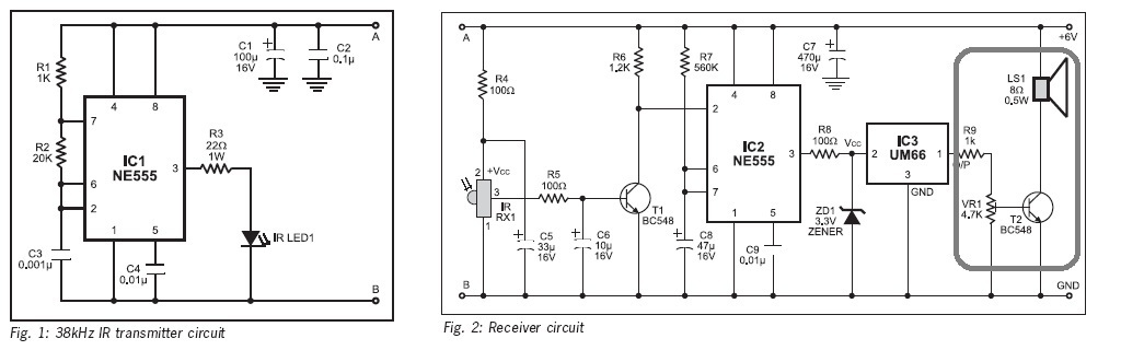

I Designed a logic design circuit that up/down counts depending on the person entering or leaving the room (previous posts) , For which i require a IR LED/ Sensing Circuit. I've applied an Idea, but can i know whether it'll be able to drive the IC's.
Here's the Circuit, Simpler Circuit is Welcomed...

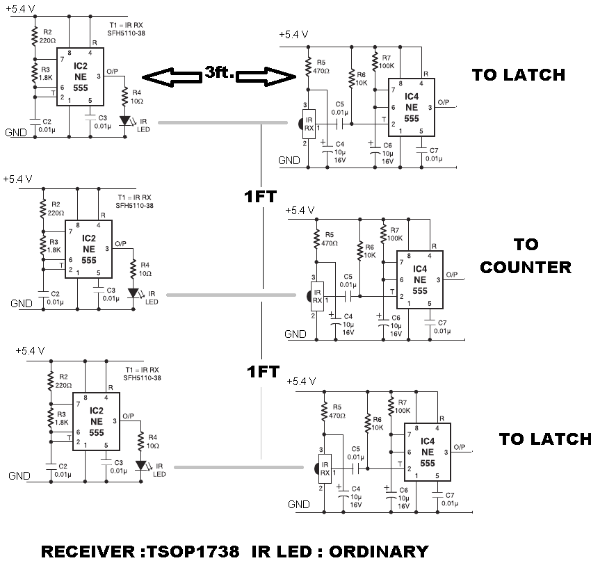

What I would do is have just 2 IR sensors spaced out slightly (about 1 foot) then have a logic circuit that can differentiate between which one was triggered first, then that feeds into the counter to count either up or down depending on which one trips first.
Try doing this with some kind of latch that resets after a second or two, and this enable the second IR sensor to trigger a clock pulse. (ie: the one further in the room is triped first, so it allows the second to trigger a clock pulse)

A quadrature detector will do the logic for a two detector design.

Actually this is not a new problem. I would start by giving this article a read. Once into that article you will come to a few suggestions, and this is one of them. Then you may want to take a look here at the 4516 data sheet and a detail of how to cascade them. The basic circuit gets you up to 15 people in a room. If you want a visual count you would decode the 4516 Q outputs to drive a display or displays. Actually if you want a simple decimal count the 4510 is likely a better choice.
You really only need two sensors spaced about 12" apart to do this and let them determine your up/down count on the 4516(s).

I'm afraid my circuit is not working....
I dont know what to do now.
I want Logic1 at the receiver end (OUTPUT).
So can anyone tell what i can do now using TSOP1738 and IR-LED ?
pls
You have too many threads for this project. It should have a single thread because in the other threads you were told how the TSOP IR receiver works.
1) Does the IR LED still work? Look at it on a digital camera or cell phone's camera. Its current seems to be extremely high and it or its 555 rdriver might be burned out.
2) Does the output of the TSOP1738 go low when it receives IR? If it doesn't then the IR transmitter must transmit bursts of 38kHz to increase the range as explained in the datasheet and in your other threads.
3) Don't you want to trigger the 555 when the IR beam is broken? Now it is triggered when the IR beam shines on the receiver.

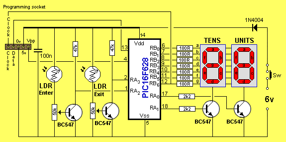

You said you wanted an UP/DOWN COUNTER - not an UP/DOWN DETECTOR.
The simplest way to produce an up/down counter is with a microcontroller.
You get all the debouncing and identification of the person entering or leaving, via the program:

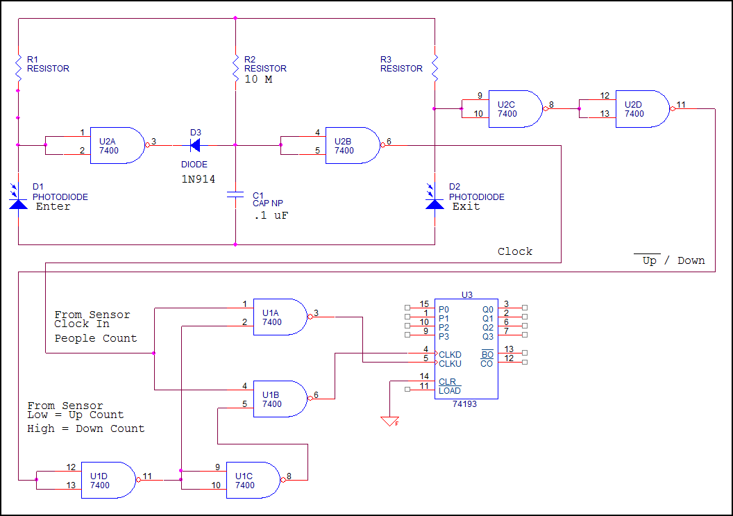

i'm using 74193 as counter, i'm already done with the logic circuit of counter, and etc,.
My problem is in "Transmitter & Receiver".
So how can i go with Transmitter & Receiver Circuit?
I just require +Vcc( Logic1) output, when someone is in between the IRLED & Sensor(Phototransistor/TSOP). i.e.,

If you are set on using a 74193 programmable up/down counter you can look at the attached circuit. Using discreet components this could have been done easier using a 4516 as was mentioned and was used in the people counter circuit I linked to early in this thread. However if you are set on the 74193 then I would work from the attached circuit. I would go with a photo diode or photo transistor as was also mentioned.
In the attached drawing the values of R1 and R3 were left out as their value depends on the used photo detector. The bottom line is what you feed to the 7400 gates as to logic. The drawing should help with the logic for up/down count to the 74193.
If you post a drawing of your logic maybe someone can come up with something better. Additionally I did not really check this circuit in any great depth so I suggest you do so.

Nice,,, but i've already done the logic design part...
Sir, i dont want the logic part,
Please give me the idea for Receiver/Transmitter?
What i can use to sense people(Circuit).
