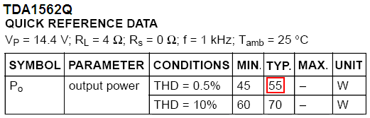

Nigel Goodwin said:
How about using a couple of TDA1562Q instead?. They provide 30W RMS from a 12V supply!.
If your car battery is being charged at 14.4V, the TDA1562Q provides 55W at low distortion to a 4 ohm speaker.
I wonder if you can hear it switch its supply voltage?

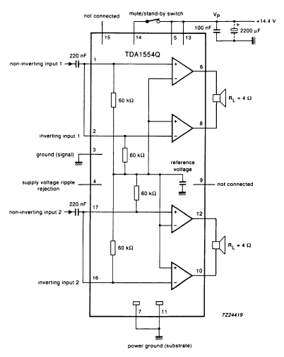

It's a LOT more complicated building a DC/DC converter than using the IC I suggested above!.
Use a simple bridged amp for car radios. They give about 14W into a 4 ohm speaker with low distortion at clipping. About the same amount of power as an LM1875 or TDA2030 that uses a voltage doubler circuit.
joecool85 said:
Do you have an example of such a circuit?
Philips makes more than 76 amp ICs and ST Micro make at least 40. Here is a simple stereo amp from Philips. The datasheets usually have a pcb layout for the circuit.
