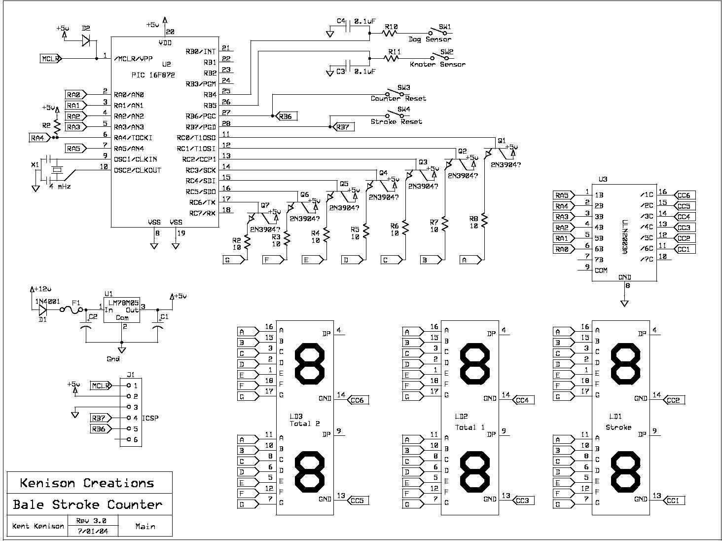

Bellow is my Sch of my project.
Are the 2n3904 the best choise?
Is there a array that would work better?
What is the lowest value for the display resistors?(max brightness)
Did I miss anything?
I would suggest PNP transistors would be a far better bet, with emitters to +ve, and resistors in series with the bases. This would give you more voltage to the displays (approaching 20% more) - you would need to alter your code to make them active low, rather than active high.
The lowest value resistor is a simple ohms law problem, based on the supply voltage (minus the drop across the top and bottom drivers), and the maximum current handling of the displays. As the displays are multiplexed, you can multiply the maximum current by the number of displays - as long as it never locks up!.

I will change to PNP, pulling the base to v+.
I'm not to clear on the calculations.
Steady current of: 30ma
Peak current of: 150ma
voltage: 2.0
Max v: 2.5
6 digits multiplexed
Is there anyother suggestions you have?
Kent
i wonder what are connected to the other ends (VCC or VSS?) of the Dog,Knoter Sensor,Counter,Reset, and Stroke Reset. Do u have plans to put pull up resistors or pull down resistors?
They are like that because of the link to the PCB drawing. They are hooked to GND and the pull-ups in PortB.

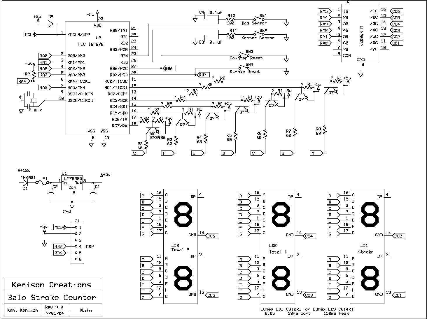

Below is a layout with PNP's. If this is the way to go, please take a look.
What should the values on the R2's and the R1's be?
Note: R2-R8 on bottom are not correct value, should be 22
R1 might, or might not, be needed - it usually won't be.
R2 isn't critical, it simply needs to pull enough current through the base of the transistor to saturate it - 1K or 2.2K should be fine, you could use the same value for R1 if you wanted to fit them.
