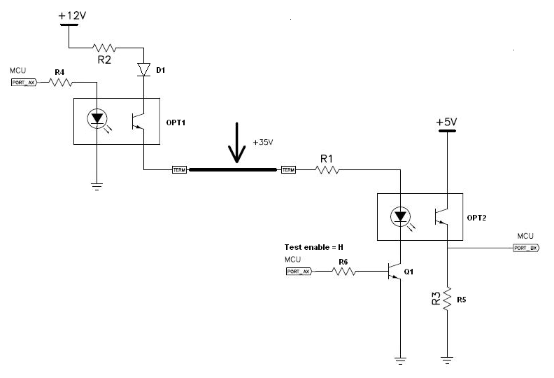

kchriste, thanks for the reply. I am attaching the sch. If you think the circuit doesn't work, could you explain more?
there are two working modes required.
1. For working mode 1, I need to test the connection of 8 lines (thick line between two terminals) to make sure there is no open on each line and no short between each other. So I use two I/O ports of MCU, one for TX transmiting HEX data to another RX port for comparing.
2. With mode 2, these 8 lines will be used to transmit 35VDC and some logic signals.

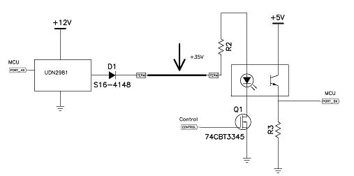

The problem with your circuit is that you'll always be injecting 12V onto the lines via R2 which will interfere with mode 2. It also won't check for shorts between the lines. Here is a modified version of your diagram which should work. You could replace OPT1 with a PNP & NPN pair or a line driver IC (with diodes) to reduce cost. The only other issue could be: can the "mode 2" circuit handle the 12V on these lines during the "test" and could it give a false test result.

Could you suggest a example part, line driver with diodes? I think the line driver should not be open-collector and the diode is for output protection, right?

Something like the TD62783APG or UDN2981, with a current limiting resistor on the 12V supply and a diode on each output will work. The diode prevents the 35V from feeding back through the line driver and into the 12V supply. The diode also makes the line driver "invisible" to the mode2 circuit when the line driver is turned off.

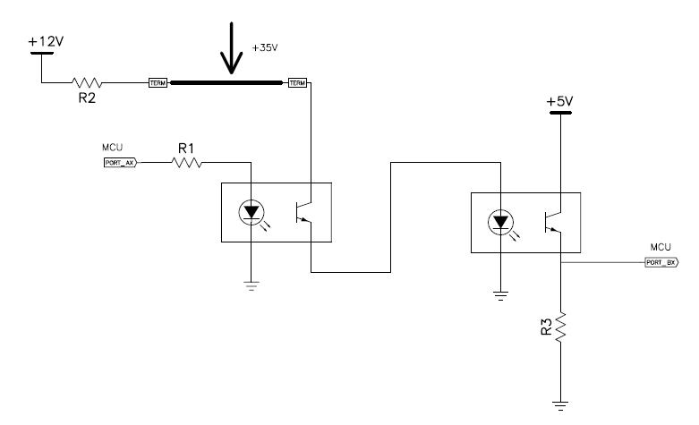

I modified the schematic, the resistor value will be computed later. Could you help me to check it again? I am using the diode array and analog switch array in the current design, the sch shows one data path.

You need a current limiting resistor in series with the +12V feeding the UDN2981 to limit the current in case there is a short to ground. (You could also put resistors on all 8 outputs of the UDN2981 instead) Otherwise, it looks OK to me.
Thank you! Although I don't expect data line shorting to ground will happen, I will still insert a resistor at 12VDC supply.
