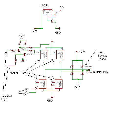

I am trying to use a PIC to control a 12V DC electric motor.
I am having problems with the noise from the motor causing MCU instability.'
The circuit is powered by a 12 V battery with a LM341 Voltage regulator for 5 V power. I already have two seperate ground planes for with a schotky diode seperating them.
Does anybody know a better way of isolating the digital power?
Post a schematic, this could be anything.
Also you want backspike diodes on the motor drivers. A schemtic of the drive section would be really helpful.
Here is the schematic.
There are backspike diodes but no capacitor.
What size of capacitor will I want to use?
The motor specs say 24 - 36 V, 2.75 A.
Whan I run it at 12 V it draws about 1 A steady state.
Thanks for the help.

Just try a 0.1uF ceramic capacitor soldered DIRECTLY across the motor terminals (not somewhere else down the wire). Size doesn't matter so much (meaning it's a black art or you don't often have enough data to make the perfect choice)...just make sure it's a good high frequency capacitor that is NON-POLARIZED (like a ceramic cap) that is rated for at least 2x the operating voltage (preferably 4).
But more importantly, it looks like you have no power supply smoothing at all to absorb voltage spikes and dips caused by the battery having a lot of inductance and taking time to react to changes caused by the motor. Place a large capacitor in parallel with your battery. For your motor I would say start with at least 1000uF electrolytic capacitor with a voltage rating at least double the battery voltage, tied as close as possible to the electronics minimizing wire length between capacitor and electronics (ie. not right next to the battery).
Input capacitors on the regulator also would not hurt (1uF or so) and something similar for the output as well. The smaller capacitors like 0.1uF should be right next to your IC's power pins, not the output of the regulator...too much inductance (ie. wire or PCB trace) between capacitor and power pin defeats their purpose. THe smaller the capacitor (a.k.a. the higher frequency the capacitor is supposed to handle) the more this holds true.
As for your separated power planes...beware...improper routing will force the return current for signals in your system to have to take a larger looped path due to the separate ground planes, causing increased EMI/RFI emission. If you don't know the caveats of split ground planes, don't use them. They can cause more problems than they solve. Read this article:
Grounding of Mixes Signal Systems
https://www.electro-tech-online.com/custompdfs/2009/01/dash_jan08_tech.pdf
He needs a 12V filter cap, too, a good sized one. A small one near the input of that LM341 is also a smart idea, and I would remove that diode from the regulator's ground pin.
Where do you have "two seperate ground planes for with a schotky diode seperating them" - ?
The regulator ground pin is attached to the digital ground plane. All the digital circuitry is grounded to this ground plane. The diode in the schematic connects this plane to the analog ground plane which is attached to the battery negative post. I thought this would keep some of the motor noise from getting to the digital circiutry. Is this incorrect?
I have .1uF capacitors near the power pins of digital circuits. I have added one across the motor, also two 4.7uF capacitors in parallel at the regulator input.
There is a 47uF capacitor at the output of the regulator. This is the capacitor that was shown but not labeled in the schematic. I suppose that this is too big and I should replace it with a smaller capacitor? How do you know what size of capacitor to use?
I do not have any 1000 uF capacitors around. I will have to order some before I can add one to the circuit.
The size of decoupling capacitors is not too critical. Larger currents requires larger capacitors (which will work decently at low frequencies but not high frequencies due to parasitics) and higher frequencies is smaller capacitors (that don't work well for larger currents because they have less capacitance).
If you get high currents with high frequencies, then things get tricky.
Lose the diode on the LM341's ground pin. It will cause temperature instability and adds apx 0.7V to the output voltage. Add a 0.1uF ceramic cap on the output and a 0.33uF ceramic on the input of the LM341. Place these as close as possible to the LM341.

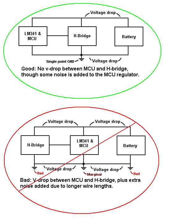

Don't run the high current path from the H-bridge through the ground circuit of the rest of the circuit on it's way to the battery. Instead have separate ground return paths for the high current and MCU circuitry. Do the same with the positive supply.
I'd be careful about that. That is making a ground loop and might cause more problems than it solves. It might just be easier to make a single large low impedance ground plane.

In addition to kchriste's drawing:
-"voltage drop" is created by the high H-bridge current running through the wire resistance. THere's voltage drop everywhere else too, but the current from the other circuits is nothing compared to the H-bridge current.
-The thing to avoid is having a "looped path of wire" where the voltage along the entire loop is supposed to be ground. In a perfect world this works, in real life this makes an antenna to receive noise and radiate noise.
For example, this would occur if you:
1. gave the H-bridge ground a separate wire straight to the battery ground
2. gave the MCU/logic ground a separate wire straight to battery ground
3. had a third wire to directly connected the ground between electronics and H-bridge
Take away one of these wires and it becomes a "star-connected ground" which is good, and not a problem. (assuming that is all there is for ground wires).
THere are tradeoffs in picking which wire not to have. Wires 1 and 2 give each section of the circuit it's own dedicated wire to ground, but signals sent between the two will have to take the longer loop since they must return using the other sections' ground wire (ie. signals sent from the MCU to H-bridge would need to travel through the H-bridge ground wire to return back to the MCU/logic section). THere is also how the groudn voltages might be different since higher currents in the H-bridge ground wire produces a larger voltage drop than the much lower currents in the MCU/logic wire.
Removing either wire 1 or wire 2 allows signals sent between the sections to return very quickly to the section since they just take the direct ground between the two sections making a smaller loop. THe catch is that the ground has effectively been daisy chained (the section farthest from the battery is using the same ground as the section closest to the battery. THis is good if the circuit with the highest current (h-bridge is closest to the battery since it will produce a larger voltage drop along the wire, and then MCU/logic with much lower current draw will have a very similar ground voltage- not so good the other way around since the ground voltage between the two sections will be much different).
