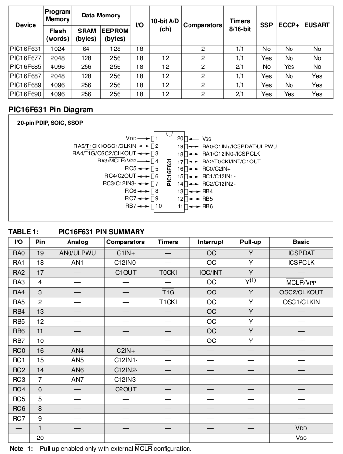

What's the difference between the 16F689 and the 16F687?
I've looked at the datasheet (see attached) but I don't understand it, could someone please translate it into English please?
The program memory of 689 is twice of 687, i.e. more program/longer program code can be stored in 689. The RAM is also twice that can be used for more data.
What does SSP, ECCP+ and EUSART mean though?
They are the features built-in in the microcontroller. Check the datasheet in detail.
SSP - SPI and I2C for interfacing with external peripherals
ECCP - Consists of 3 module, PWM is one of them
EUSART - UART or USART for communication
[SIZE=-1]SSP: Synchronous Serial Port
ECPP: Enhanced Capture/Compare/PWM module
EUSART: Enhanced Usart module (RS232)
EDIT: bananasiong, we were posting at the same time :)
